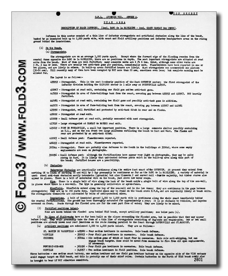

    I found a very useful document titled "Operation Neptune - Naval Operations Orders" on Fold3. If you have an account with them, the mammoth report is found by drilling down via:
    World War II > WWII War Diaries > A > Allied Naval Commander-in-Chief Expeditionary Force
    The first page is located here and the last, page 3562, is here (viewable by login only). I mention it on this thread because on page 2800 I found a reference to your map reference 392057 - well, actually 392056 but it’s close enough to be the same location:
    The intelligence is dated the 14th April 1944, so unless Wn 14A was strengthened significantly afterwards, I doubt if the 'duel' between the two batteries could have been on an equal footing - that's not to say of course that it did not take place!

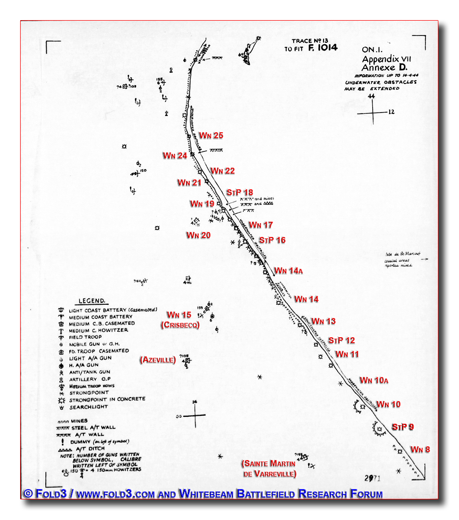

    I marked in on the map below (taken from the same report), my interpretation of the Widerstandsnest (Wn) locations shown on another map - page 7 of "Utah Beach - Sainte Mere Eglise - Sainte Marie du Mont" by Georges Bernage and Dominique Francois:
    The two maps are not exact in matching the locations precisely but they are close enough in my view as some of the smaller Widerstandsnests are very difficult to find today. However, if anyone spots an error in my labels, please post a correction.
    Below is the full page 2800 referred to in my last post above:
