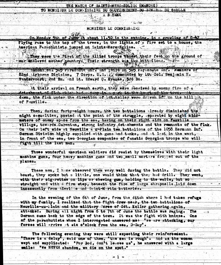

    As for the letter, its pretty odd overall, given the narrator's awareness for battlefield events and his recommendation for an award. There isn't a date, but it could probably be estimated because it is addressed to De Gaulle's government at Bayeux. This comes from a huge file hosted on the Fort Benning Library website: http://www.benning.army.mil/library...nts/Microfilm/film/D1-D630/D78_I2000-2019.pdf, pages 527-528.
    Here is what I read: "At their arrival on French earth, they were received by enemy fire of a detachment of flak which had a camp in a park in the heart of the town. At dawn, the flak under the direction of Cdt.Koller were driven off the hill of Fauville."
    To me, it appears that he is talking about actual weapons but, the Mayor could also just be referring to them by their role/unit name and not talking about actual pieces of equipment.

    Thanks for posting Steven. It's a long time since I last looked at these particular microfilms (I wish the quality was better). I've little doubt that the document was originally written in French and that somehow a copy found its way to the division. The tekst is slightly odd, but that may not all be caused by poor a translation. I do believe though that it should have been "At dawn, the Flak under Cdt. Koller were driven off to the hill of Fauville."
    I do have an original copy of the Mayor's book (published in 1945 on very poor quality paper) and will check what he wrote exactly. However, he always seems to calls the Luftwaffe soldiers 'Flaks'. I do assume he did the same in his letter. Which means that it is only about personnel, not guns!

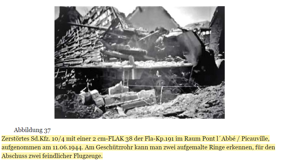

    The authors, of course, later on just casually toss this picture in there from a NARA film archive. Wrong vehicle type and wrong gun for the unit, and of course this doesn't look to me like an Sd.Kfz.10/4 mit 2cm Flak 38...more like a Sd.Kfz.7 mit 3.7cm Flak 36.

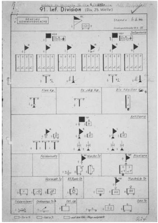

    It certainly would make sense for the division to have divided its 20mm gun company between the major subordinate units. 1057th could have a section placed on high ground near where it had soldiers working (they were cutting trees down apparently). The Pioneers were the major combat unit in proximity to the division headquarters, so their awards could have come from subordinated gun sections, or from some good shooting by their organic machine guns. Pz.Abt.100 with its positions spread around Ste-Mere-Eglise could have owned the Fla.Kp. HQ for administrative purposes and this could explain our previous discussion about the commandant and the "flak troops" we had earlier. Besides, placing the mechanized units together allows a few other advantages. Anyway, whatever. None of this could be correct, or perhaps all of it.

    Although I've been in contact with one of the authors of the 91.ll. book, they never took my offer to proof read stuff for them. I've asked some questions in the past but getting clear answers has often been a challenge (there have also been some language barriers). Anyway, I was slightly surprised by the format of the end result (mainly a collection of sources) and there are also some errors in the book that could have been avoided. However, all of this is typical for enthousiasts spending a lot of time researching relatives (both authors had a grandfather in the division), but it can be difficult to get sufficient knowledge on particular topics. (Which is why I offered to help.)
    The halftrack image is an example of that. The vehicle belonged to the 3,7 cm company I mentioned already. This unit was most likely tasked with defending the Douve bridges, and the Flak from the 1057 account might be connected. I am however unfamiliar with that particular story.
    As for the division's own flak, its distribution is a mystery, but based on the available information from the later fighting, it would appear most was actually deployed in its sector between Baupte and the Douve, also the core sector of Pz.Abt.100. The 508pir encountered a lot of 2cm fire there, and if I'm not mistaken the company was so short of ammo that it did not actually engage aircraft.

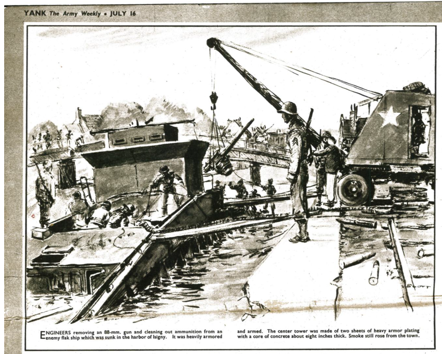

    Its not quite the Douve, but there was a disabled (apparently it hit a mine in May) Artilleriefaehrprahm (apparently AF 64) docked in Isigny on the 6th. Its guns probably remained operational though. One of the NCAP aerial photos shows one of the main turrets trained off to the NNE. Yank even did a cartoon of it sunk at the quay.
