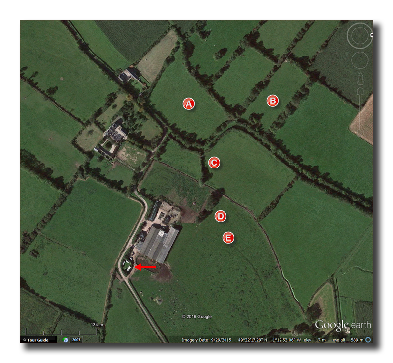

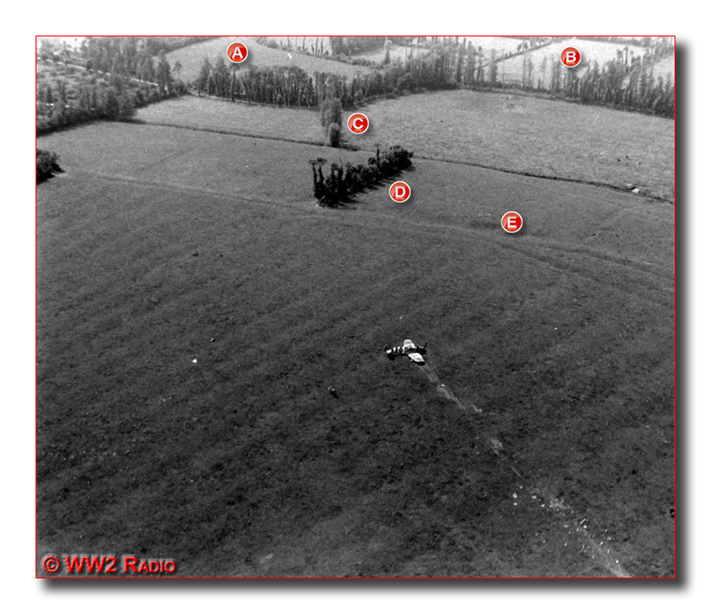

    Aircraft in question, correctly orientated with Pat's tie ins:

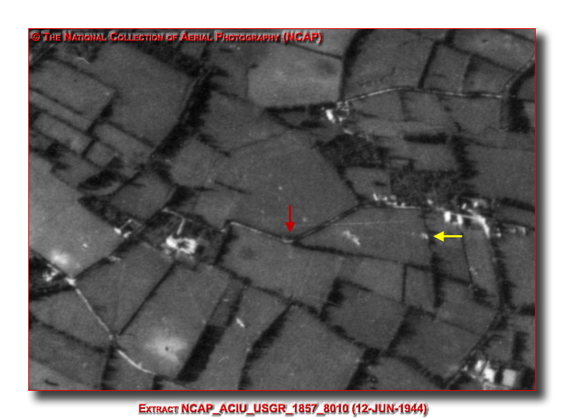

    It may be visible on the famous 8010 frame, which would put the date on or before 12th June, limiting the options above to F/Sgt Gough and possibly F/O Lowes:
    The location being 11 o'clock from the tail of the red arrow.

    As 193 Sqn have three possibilities in the above list, including one "likely" if the aircraft is visible on 8010 (12th June), it makes sense to check out their ORBs first.
    Photobucket is down at the moment so I can't post images.

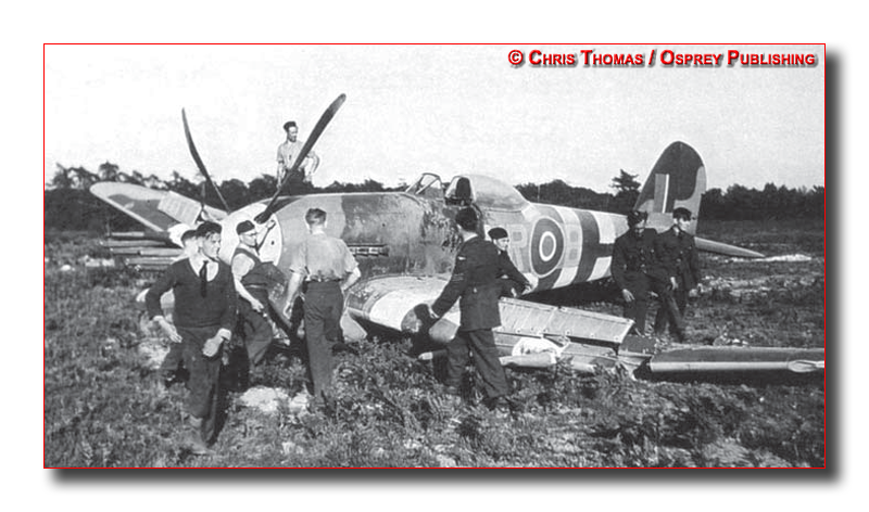

    Below is the wreck of Flying Officer W. Smith's Typhoon marked 'MR-B' (MN625). This photo is taken from page 61 of Chris Thomas's 'Typhoon Wings of 2nd TAF 1943-45' and appears to show an RAF recovery crew at work on the wreck:
    The caption reads:
    The reference to 'ten days later' is going back to the 10th June, when F/O Smith stole the show from AVM Harry Broadhurst at B-3 Ste Croix sur Mer by becoming the first Allied pilot to do a wheels down landing in France following D-Day - see that story in the '245 Sqd Typhoon 'MR-K' on ALG B-3?' thread. Thus, as far as I know, F/O Smith had escaped from at least three crashes/forced landings in just 15 days! He had to ditch in the Channel 30 miles north of Cherbourg after being hit by flak on the 5th June.

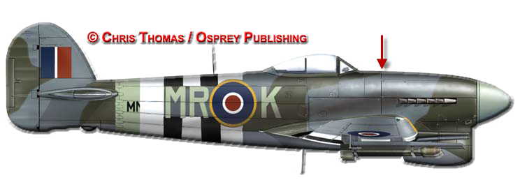

    But back to 'our' wreck. I am pretty sure that its not F/O Smith's 'MR-B' because there appears to be a crack between the fuselage and engine compartment as indicated by the red arrow in the re-worked blowup below:
    If this crack is present, it appears to match well with the joint location in the drawing below of F/O Smith's 'MR-K' - though I don't suppose there is much difference in the joint location between the other fighter makes:
    Apparently it was quite a dangerous task to belly land a Typhoon because of the large, protruding air intake under the nose. If the nose was not held up on impact, the air intake would dig in and flip the aircraft onto its back. I note that the field in the photograph has ridges in it, which would not have helped in this regard, if this is a Typhoon (or Tempest). Perhaps the experienced pilot who landed this aircraft, succeeded in holding the nose up until the last minute and then when the nose came down near the end of the run, the air intake caught on a ridge, causing the crack in the joint.
    Anyway, does anyone else see this crack? :huh:
    I am quite a bit less sure that there is damage to the upper part of the vertical stabiliser and rudder. This perception of mine could just be the angle of view and in any event the vertical stabiliser on a Typhoon is not very high.
    Just some thoughts guys.
  7. Sean
    RE: Possible Typhoon Brucheville
    Yep. It's where the firewall/bulkhead is. The engine, the heaviest part of the aircraft, is in front of this. If the mounts buckled or broke, then I reckon this would cause a break similar to that visible.
    Equally though, as you point out the Spitfire has a bulkhead in the same place.
    For now, I think Gough's aircraft is a good candidate to start with.The squadron codes were 'DP', which in 'our' view would be behind (left of) the roundel. It lookd like there's some paint visible in the rearmost white Invasion Stripe. Doesn't look much like a 'D' but reflecting light may be playing tricks...
    As I posted this another doubt set in as it would seem more in keeping with a Sptifire for the code to sit that far back...:-/

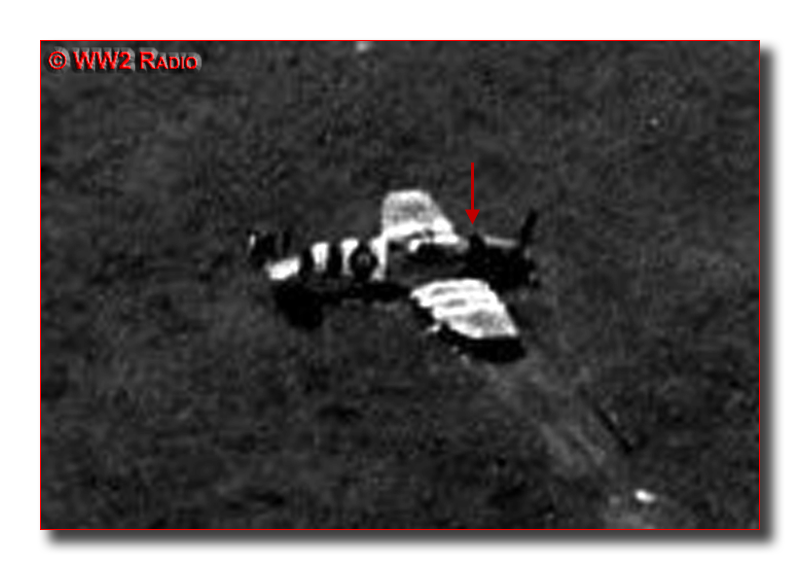

  8. John Szweda
    Hi guys,
    I see the crack at the firewall, but I have another question... Is it a crack?
    Do you think it appears that the plane was censored in some fashion with black marks?
    Do you see some marks across the vertical stabilizer maybe made to censor some markings in the shape of XI on it, possibly even across the invasion stripes and another mark under the cockpit? Even the propeller blade looks a bit square to me.
    In a four bladed prop, why are we not seeing more blades?
    I don't know what to make of it, but do you think this plane has been censored?

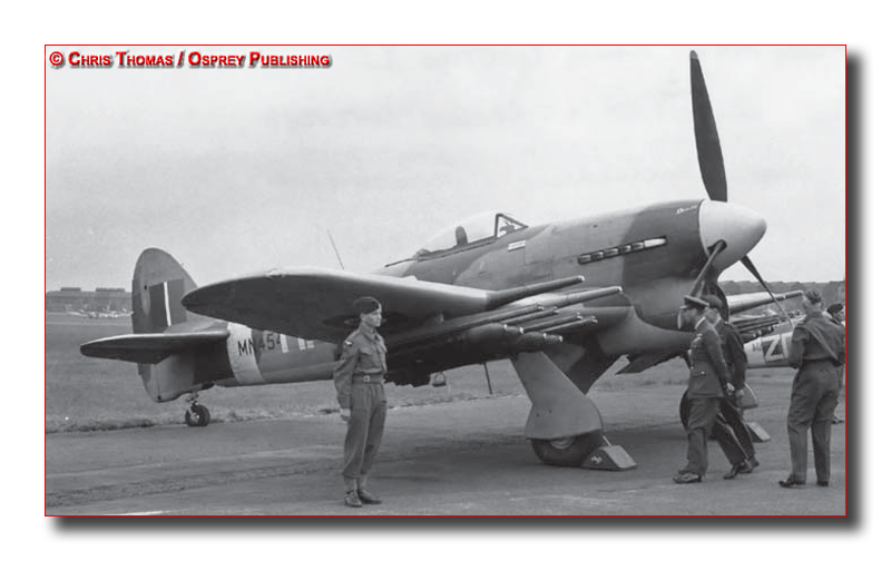

    Apparently both three and four bladed props were in use during the Normandy Campaign. Below is another photograph from page 55 of Chris Thomas's 'Typhoon Wings of 2nd TAF 1943-45':
    The caption reads:
    I think we are seeing the three bladed version here, with the single blade pointing up having survived the impact because the engine was already stopped before the belly landing.
    Just can't be sure of any marking John, but the angle downwards of the engine compartment towards the propeller, when compared to the way the rest of the fuselage sits in the field, convinces me that it has broken away.
  10. John Szweda
    Do you notice how the firewall break extends up higher than the actual fuselage a slight amount? You wouldn't expect the black to extend beyond the fuselage.
    I'm not saying it isn't broken, but could there be a squadron emblem censors may have tried to hide?
    Also zoom in on the Tail, can you see a sloppy XI possibly made by censors in black covering the vertical stabilizer? Even thought this is the shady side of the plane. the coloring is off or curiously uneven.
    I may be wrong, but it is what I see...
    I wonder where the WW2 Radio FB site owner(s) are getting these photos from? I doubt very much that we are seeing full resolution copies of the photos shown - notwithstanding the credit due to them for posting the lower res versions.
    I see what you mean about the black marking, but I remain cautious as to what it is.
