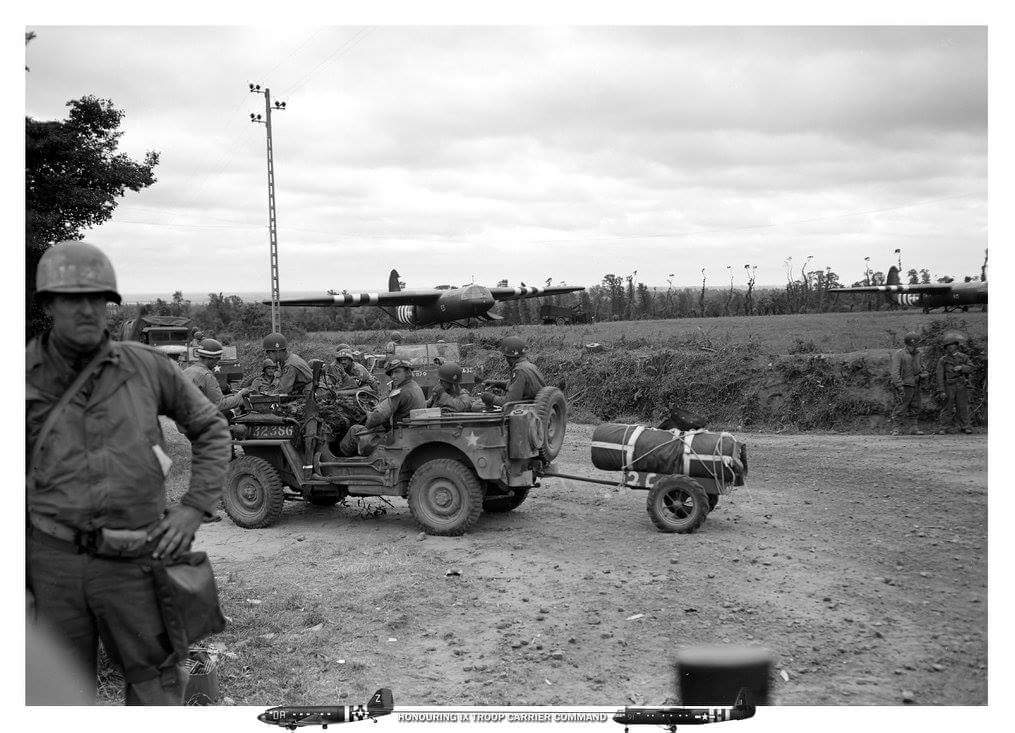

    This photo has always been one of my favourites of the D-Day invasion.
    [IMG=850x671]http://img.photobucket.com/albums/v464/jonesy1275/101st-airborne-and-handcart_zps1fccfaa5.jpg[/IMG]
    Patrick told me where the photograph was taken as I'd always assumed it was taken around Hiesville. What I'd like to know is more about the Horsas. Which mission were they part of, which squadron and does anybody know who the glider pilots were?

    The reasons for me having an interest in this photo. Well, I think the Horsa is an absolute beauty. British at its best although some would disagree due to the amount of crashes in Normandy. Also the jeep and handcart has a special place in my heart as I own them both too.

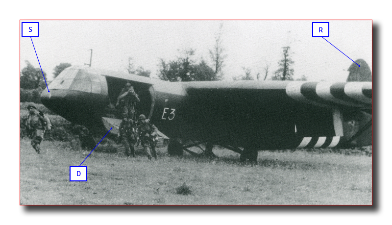

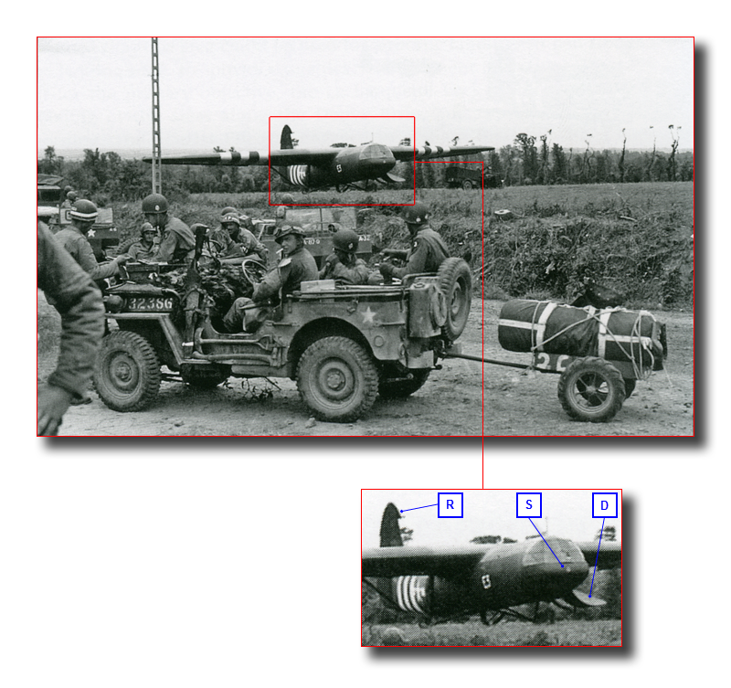

    As you probably know, there was a lot of still and movie film shot at this crossroads. We did do some work on the Horsa in the background which has the airborne No. 'E3'. An extract of the high resolution version of your photo below shows this number quite clearly:

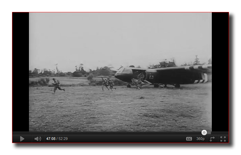

    I cannot recall if we all agreed at the time, but I was pretty certain that the same Horsa was used in this feign footage shot from E3's port side:

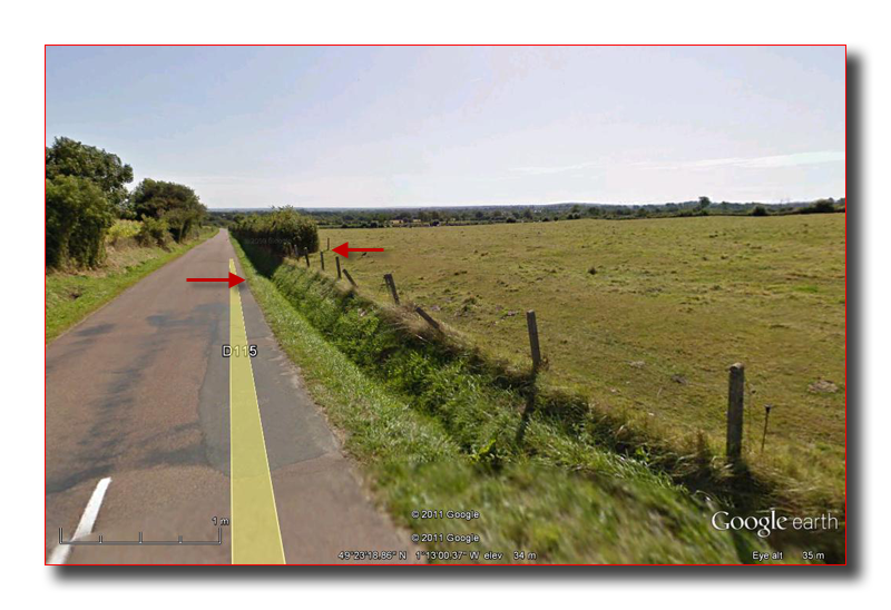

    Note points R(Rudder position), S(Spot on nose) and D(Door ramp down) for ties. The red arrows indicate a concrete power pole, one down from the pole in your photo.

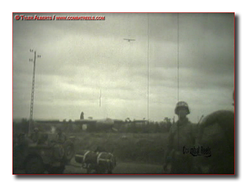

    Tyler Alberts has some extra footage on some of his DVDs as well:

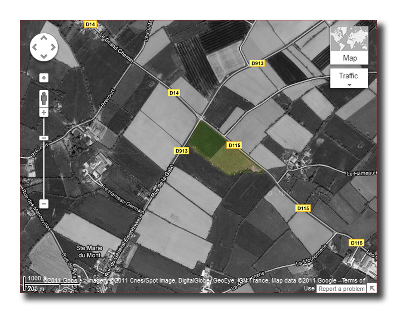

    For those readers wondering where we are, E3 was in the upper, un-grazed half of the field highlighted below:
    As to what squadron E3 belongs to, I do not know but I think we had considered her as being one of the 'Keokuk' gliders. If this is correct, then she must belong to the 434th Troop Carrier Group (71st, 72nd, 73rd or 74th Troop Carrier Squadron).

    Do you know which DVD of Tyler's has that footage that you've taken screen grabs?
    Neil,
    There is quite a bit on the 9th Infantry Division - Invasion of Normandy Series DVD. The link will bring you to a newer version of this disk than the one I used but I am sure the same sequence is on that as well.
    You can see the GIs' turning their heads to the left as E3 suddenly appears visible at about the point indicated by the red arrows below. Note how the field appears to be slightly higher than the road surface, so E3 would have been an imposing sight at first glance:

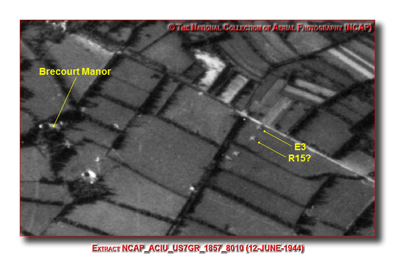

    Hi Pat and Neil,
    I do remember seeing an aerial photo of this area somewhere that included the Horsa gliders, but I cannot remember where. I did quickly search the NCAP site aerials and it was not there.
    I do know however that it can be seen in the aerial US7GR_1857_8010 along with the Brecourt area.
    Pat, maybe you can post an extract here when you have some time.
    Also do you think Col Roy Stanley II may have an image somewhere?
    Neils, a copy of the same aerial is available in our "green room' under resource files > "NCAP High Resolution Frames" in a large tiff file.

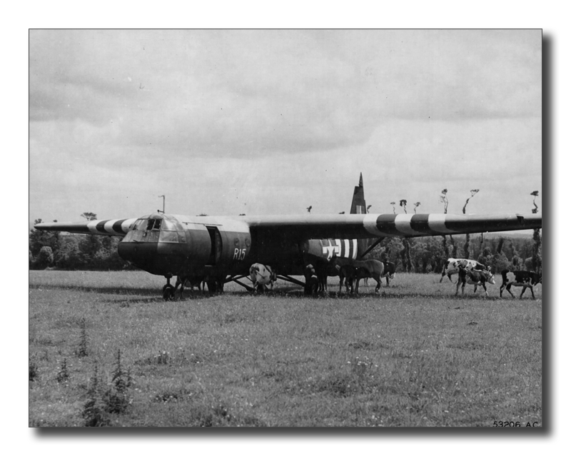

    There is a well know ground photo of Horsa 'R15' with accompanying livestock but I have never been able to place it until now:

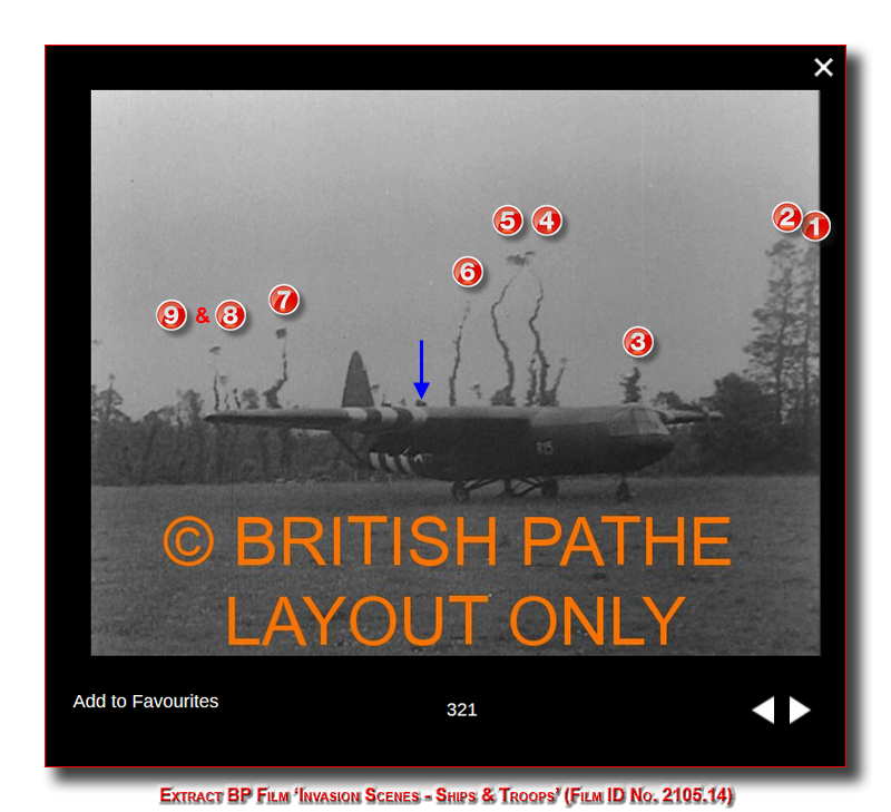

    I found new footage of 'E3' which has not been considered here before. It is contained in the BP Film 'Invasion Scenes - Ships & Troops' (Film ID No. 2105.14). Below is a still showing what I believe to be a new view of the front of 'E3':
    The next scene shows another new view of 'R15' from her starboard side. I have never seen this side of her before and I have little doubt that it is one and the same glider as that shown in the well known ground shot with the cows and horses:
    The problem is that the camera does not pan between the two gliders, but the new 'R15' scene does give us new clues by way of tree 'fingerprints'. Note trees 1-9 marked above and the blue arrow which is pointing to a short, stumpy tree trunk.
    While the all seeing NCAP_ACIU_US7GR_1857_8010 (flown on the 12th June) does give us perspective on the location, the extract below is not going to provide us with the 'fingerprints' we need!:

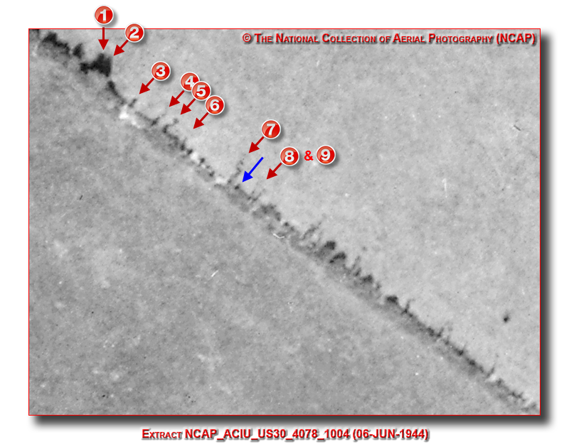

    I then remembered the first NCAP (then TARA) image which I purchased many years ago during my BofB phase. I got it to see if the Brecourt Battery positions could be seen. Anyway, it also contains an excellent view of the new backdrop to R15 and, while not conclusive, I believe there are several good to excellent ties showing in the tree 'fingerprints':
    I especially like 4,5 and 7 :D
    What do you guys think?
  17. Jonesy
    223
    Pat, you're correct. The photo I have of the jeep and handcart features both Horsa gliders in the frame. I'm not at home now to post it but I've posted those photos on my FB page only a few days ago.
    Hi Neil,
    Thanks for the update. I Googled the phrase 'Horsa "R15"' and found a book titled 'The Americans on D-Day: A Photographic History...' by Martin K. A. Morgan which again places R15 in the field at the crossroads with E3. However, is this certainty based solely on the BP footage which I referenced in my last post?
    If so, I would worry about the break in the film between the two gliders if the tree 'fingerprints' were not present. A lot of still and movie film shots were taken at the crossroads and there are two additional Horsas present in the adjoining field to the SW.
    What I am getting at is - did Martin Morgan have another source which placed R15 in this field?

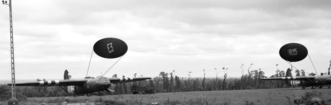

  19. Jonesy
    223
    The high res version of this photo clearly shows that it is R15.
    A close up of the chalk numbers from the above photo.
    The Holdy Horsa had a chalk number of R5 in the same font.
    Thanks Neil,
    Failed to see that one :blush:
