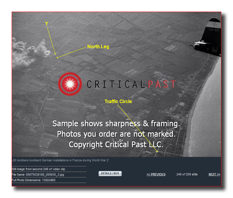

    Have look at this Critical Past footage which shows both attacks on the River Seine crossings and also the two strong points WN16 'Morris' and WN17 'Hillman' at Colleville-Montgomery.
    Below are some screenshots from when we first found the 'Morris'/'Hillman' location on the old 'Battlebus' forum:
    I wonder if this might not be the 'Caen RJ' target?
