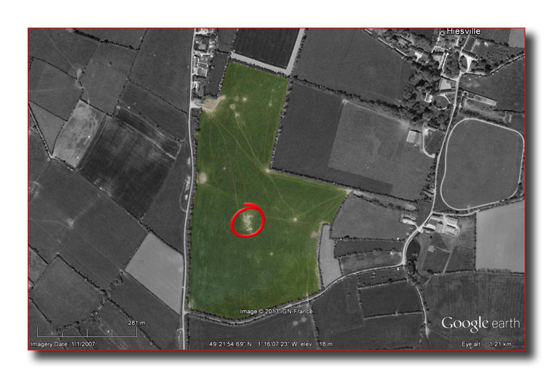

    I am anxious to have a look at the Pond Field as another possibility for Brigadier General Pratt's crash site because of the sketch map appearing on page 100 of the book "Utah Beach - Sainte Mere Eglise - Sainte Marie du Mont" by Georges Bernage and Dominique Francois.
    Here is the sketch map again:
    Regular readers will recall that we had done extensive work tying up various photographs and footage in what has been now termed the 'Pond Field'. This field has the markers '3', '4', '5' and '6' marked thereon in the said sketch map above. The caption reads:

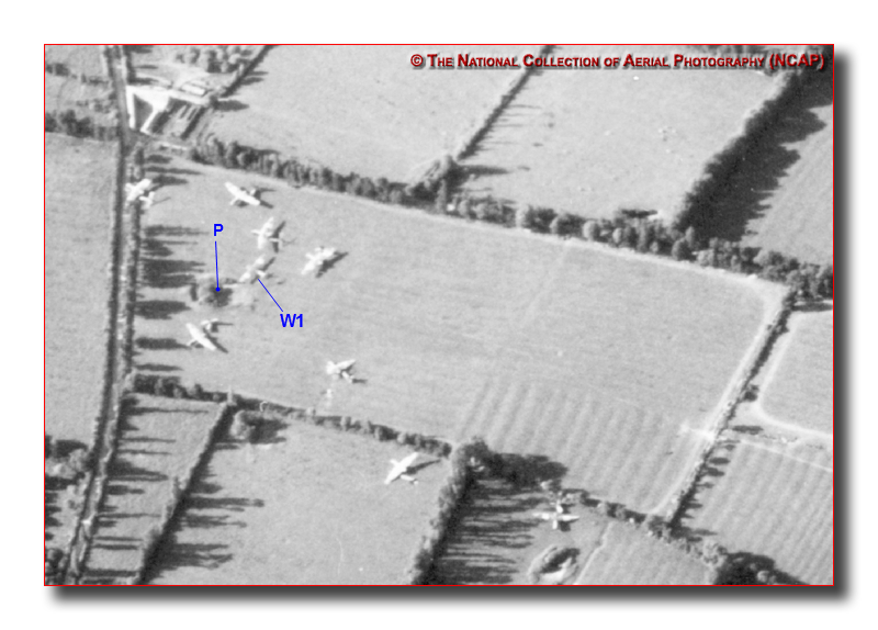

    Below is a GE screenshot with the pond which gives the field it's name marked 'P' and the house which is marked 'Maison Doline' on the sketch map circled in red:
    For those readers who may not be familiar with our previous work in this field, here are a few of the screen shots we used:

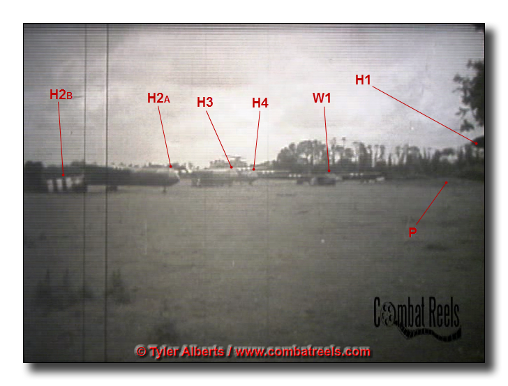

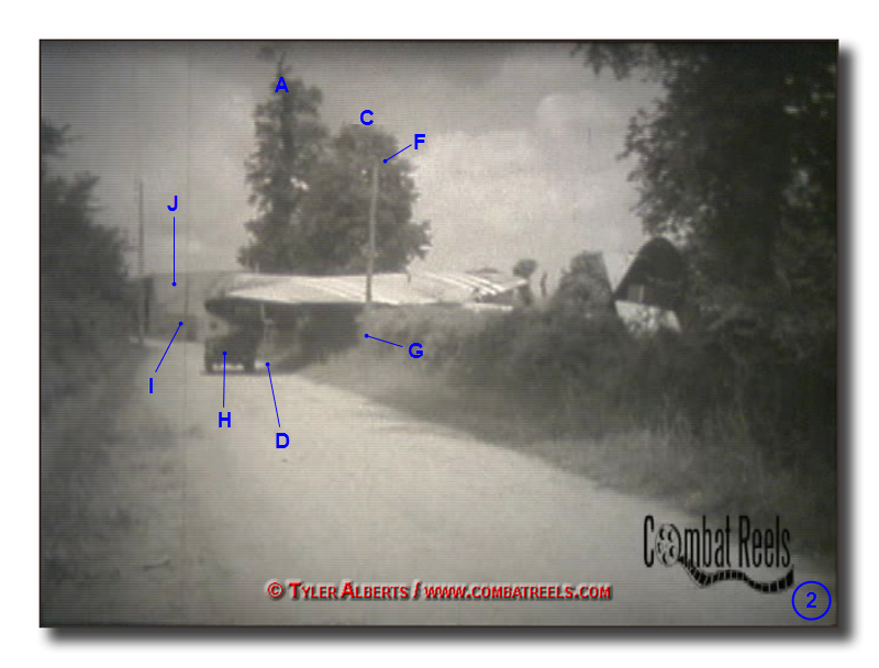

    Footage still below was shot from position 'C' above:
    The sharp eyed reader will note the difference in the position of Horsa 'H1', seen below before it was pulled back out of the hedgerow to allow access to the shortcut leading to the hospital at Chateau de Colombières two fields to the east:
    ...and a closer ground view from footage shot at the scene with the name 'Edna' now visible:

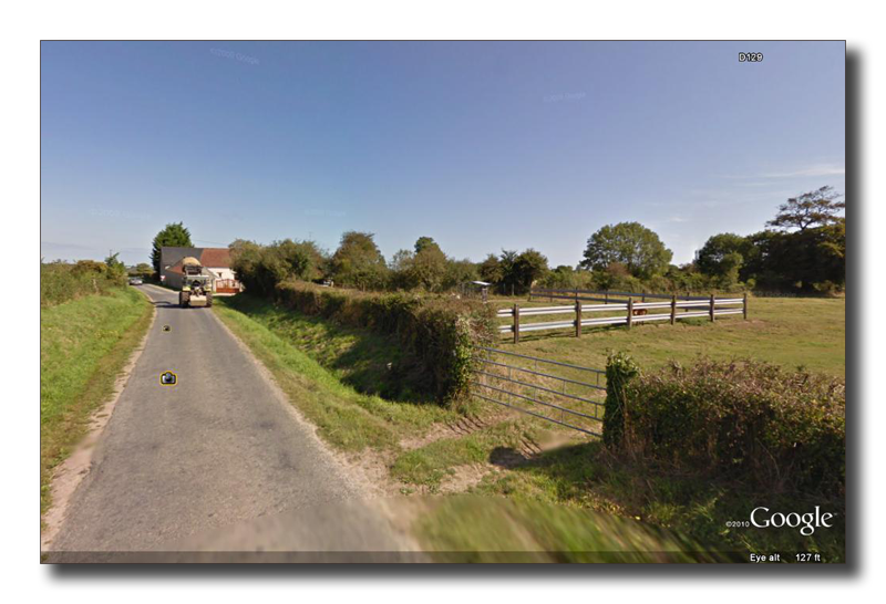

    One final screenshot from GE 'street view' of the same stretch of road today:
    OK, so what has led to this field being considered as a candidate for Brigadier General Pratt's crash site?
    During the research tying up the above photographs and footage, we purchased a high resolution copy NCAP_ACIU_US7GR_1857_4052, flown on the 12th June. The extract below shows a good clear view of the Pond Field due to a combination of a sparse tree line on the southern hedgerow and the sun shining from a low angle in the evening sky. There are however, some shadows remaining:
    Can anyone see another Waco in the field apart from ‘W1’ at the pond?
    One other thing has just occurred to me when tracking down all the above screenshots on my hard drive…why was this field photographed and filmed to such an extent? Were the Signal Corps photographers searching for Brigadier General Pratt’s crash site and stopped when they saw the Horsa ‘H1’ ("Edna") in the hedgerow?
    Strange… :huh:

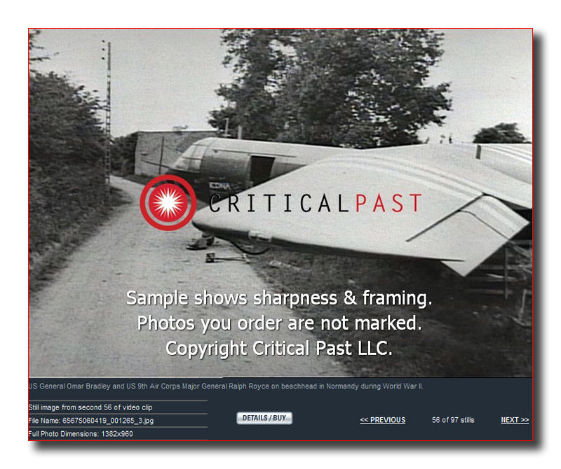

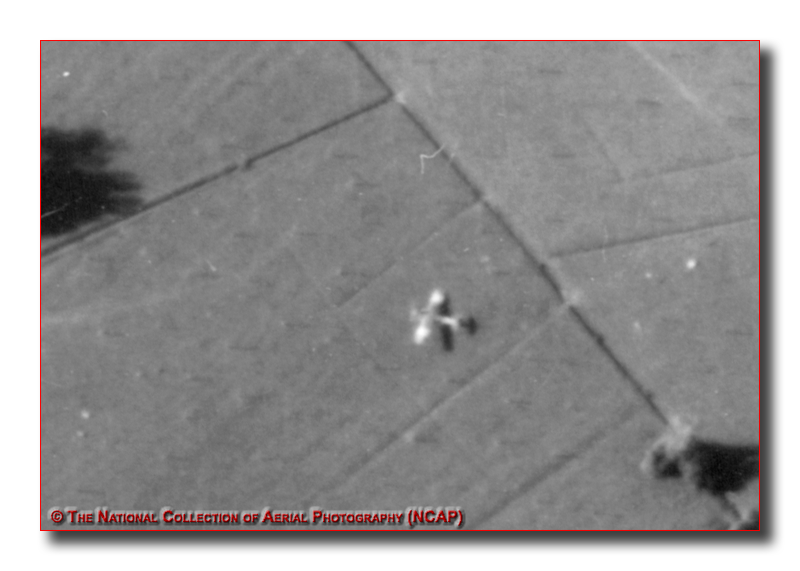

    In any event here is the extract from NCAP_ACIU_US7GR_1857_4052 flown on the 12th June with the 'Big Dipper' Horsa grouping on the marshland west of Vierville:
    The Waco I think you are referring to is marked circled '1' on the left of the extract. Below is a zoomed view:
    I cannot recall that we ever established the tail (serial) number of this Waco... We did find some ground photographs from the Harold Palmer and Willie Hein albums on the The WWII 300th Combat Engineers site, one of which is reproduced below with the kind permission of the site owners Brad Peters and Jan Ross:

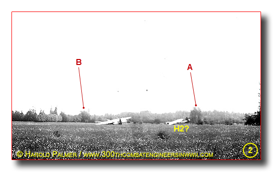

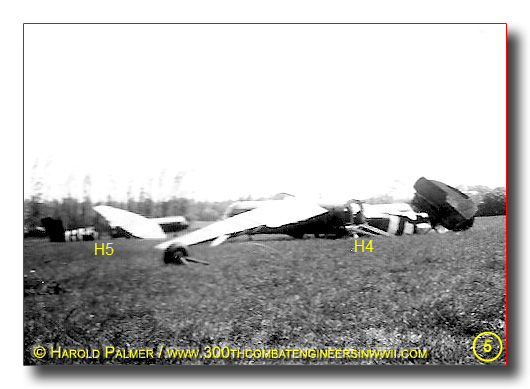

    Image Credit: The WWII 300th Combat Engineers / www.300thcombatengineersinwwii.com
    The photograph was taken I suspect from the position on the aerial extract marked circled '1' but I am less sure of this that the other photographs taken by Palmer and Hein at the same location. Here are the others, with more and more certainty on my part as the photographers walked towards Vierville from positions 2, 3, 4 and 5:

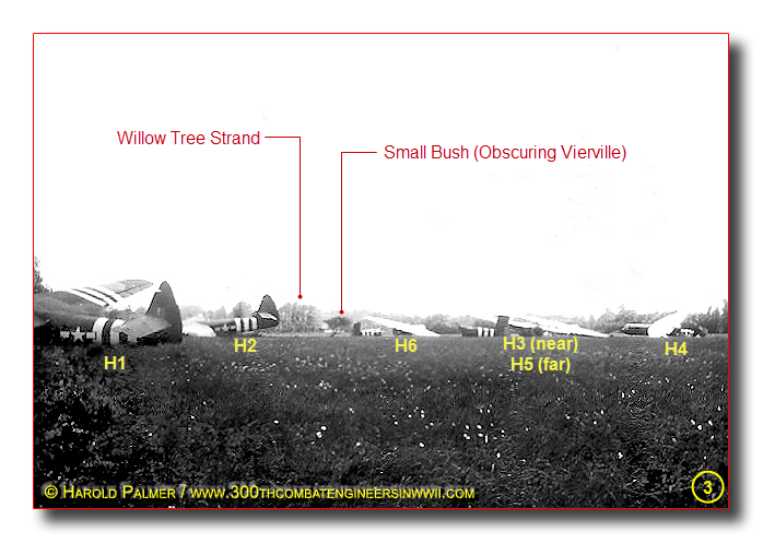

    I cannot see the tail number on the Waco marked '1' in the ground shot, but as I say, I am not sure it is the same as that marked '1' in the aerial extract. It just feels right ;)
    The 'Rommel's Asparagus' pole in front of the starboard side wing worried me until I realised it's shadow, which must be pointing east like the others as indicated by the black specks in the zoomed aerial extract, is hidden by the raised cockpit and starboard wing.
    If this is not the Waco you are looking for, let me have more details and I'll track it down.

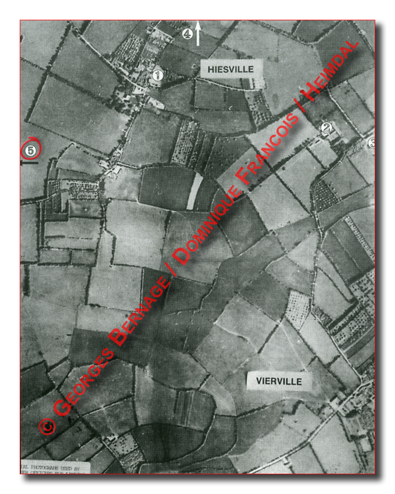

    As I understand it, glider pilots were given a specific field as a primary landing site and told to move to others if things did not go as planned. I am wondering about that extract from the pre-invasion aerial photograph in the book "Utah Beach - Sainte Mere Eglise - Sainte Marie du Mont" by Georges Bernage and Dominique Francois, shown on 84, reproduced below again:
    Specifically, the black arrow at '5'. I would be pretty sure this aerial was used to brief glider pilots prior to the invasion - the label at bottom left appears to read something like "...IAL PHOTOGRAPH USED BY [line break] ?? OFFICERS FOR LANDING". If this is a correct caption and if the numbers and arrows are from the original document, then what is the black arrow at '5' pointing at?
    To my mind, there is a high probability that it's pointing to some form of landing aid for the glider pilots in the middle of Pratt Field.

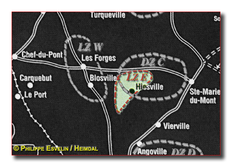

    If we look at the shape of LZ 'E', the southern extent of the kidney shape appears to have been included to facilitate the inclusion of Pratt Field:
    The shape must have been dictated by the selection of suitable fields as close as possible to the 101st CP at Lecaudy Farm. Pratt Field is by far the largest field of all within LZ 'E' and therefore, in my view, would have been an obvious location for planting a landing aid for the gliders. Within Pratt Field then, I also wonder if the landing aid was placed in the depression both as a finding aid for the whole LZ and a warning to avoid the danger of hitting the unsafe portion of the otherwise ideal field?

    .....For LZ "E" - Team E consisting of Stick 3, 502nd Parachute Infantry, Lt. D. C. Driver, Jumpmaster and Stick 2, 377th Parachute Field Artillery Bn., Lt. L. J. Hensley, Jumpmaster.
    TEAM E was scheduled to drop on DZ C at 0027 at Point 393-927 and landed approximately 0029 at point 395-895. Both sticks were together when dropped and Lt. Driver assembled his entire stick in approximately ten minutes. Lt. Hensley was missing five men on the assembly. These two teams were to mark the LZ at two points with the base stick establishing the Eureka. Eureka was established at approximately 0330 by which time the two sticks had moved to the correct LZ's. Eurekas were turned on at 0350 and reception was made with transmitting aircraft prior to 0400. Both teams established lights but those established by Lt. Driver were knocked out by a landing Glider at approximately 0420. Lt. Hensley kept his lights on until approximately 0445.
    By this time all echelons of gliders that were in the air had landed and the pathfinder personnel worked from this time until approximately 0800 orienting personnel and removing injured personnel from smashed gliders.
    On DZ E: Eureka established at designated point and lights set up at both designated points on scheduled time.

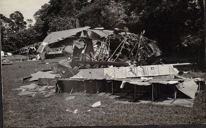

  17. Hello everyone.
    Very, very interesting topic here.
    Some of you might have seen these pictures on the Triggertime Forum a while back, but I took them off again. I am researching the 9th Infantry Division, and came in touch with a woman whose father kept diaries, and took many pictures! She wants to publish her father's diaries, and I am helping her. Her dad served in the 60th Field Artillery Battalion of the 9th Infantry Division. You can imagine my amazement when she showed me several pictures of wrecked gliders!
    Here are the two pictures that might be interesting for this topic:
    [attachment=19]
    Photo description written on the back says:
    "July 12 1944 - Near Caretan, France - Gliders wrecked in invasion 1944".
    [attachment=20]
    "July 12 -1944 - Near Caretan, France - Wrecked glidets from invasion".
    Unfortunately, the soldier does not mention these particular wrecks in his diary. The only clue I could find was this entry in his diary, on July 12th, 1944:
    "We went back through Carentan to Blosville and then to Division Rear at Hiesville".
    So, this indicates that on that day, he was in the Hiesville area, and must have taken the pictures there.
    At the moment, these pictures are the only ones I have. I will ask my friend to make new scans of these, more clear and detailed. When I have those, I will post them again in this thread.

  18. John Szweda
    Hi Yuri,
    Thanks for sharing the photos!
    These two photos look like they might have been taken from the opposite sides of the same location where 2 gliders came to rest. The lower wrecked glider looks very much like it could be General Pratts glider taken after they pulled it out from the hedgerow. If you compare the earlier photo of the Officer standing in front of the glider with the cut canvas of "The Fighting Falcon" they look like a match. Take into consideration the the "Fighting Falcon " photo was taken on the 6th or 7th, and the one just posted by Yuri fromthe diary was taken on the 12th.
    Now look at the other glider photo with the now collapsed wings. In my opinion you can see the wreckage of the other glider (Pratts) and you can see the tail of it for sure just above the canopy of the glider.
    In my opinion I feel strongly that this is area 6 as marked by Pat in some of the aerials and I think if Yuri is able to get a higher resolution scan in the future, we might be able to even see the additional Waco's in the distant hedgerow (that we can see in the earlier aerial photos).
    Any other opinions on these photos? I am very interested in what else we can learn.

    Hi Yuri and John,
    I recall seeing these two photographs on TT when you had them up Yuri and I never could be sure one way or the other. One thing I do notice is that the jeep track leading to the bottom left would be about right if it was exiting 'Pratt Field' at the present day gateway between the recycle bins and the corner of the field.
    Was there not another photograph of a Horsa in the same collection? IIRC, someone on TT asked for an enlargement of the tail section. I recall being slightly more confident that that Horsa photograph could have been tagged to the 'Big Dipper' area.
    I have little doubt that the 'Flying Falcon' (replacement) became a tourist attraction for amateur photographers once the location of the crash became known. My guess would be that higher resolution scans will not add detail to that which is already there, but it is certainly worth a shot.

    Looking at the shadows cast, I would say:
    Photo #1, the intact Waco left wing view - not much to work with, but my best guess is the wingtip is pointing generally to the North. Even if correct, this could have a wide margin of error, so best not to assume anything more precise than somewhere between an arc encompassing 300-60 deg. A sharper image could help, but the main limitation is that the wingtip is close to the ground and thus doesn't cast much of a shadow. If my guess is correct, then the hedgerow on the photo's left edge runs about 240-60 (approx. WSW-ENE). The eastern half of the southern border of the Pratt Field fits comfortably into that range, but my stated accuracy reservations leave me queezy. Do I understand those with actual knowledge of the site that the slope fits the bins location?
    Photo #2, the mangled wing section - the sun is very near its peak - high noon - for July 12 (in fact my first assessment estimated the sun elevation at an angle which doesn't occur at that latitude on that date). My assessment is that the hedgerow behind the wreckage runs at about an axis of 25-205 deg (and looking NNE), with perhaps a 15 deg margin of error.
    With Photo #2 having crisper shadows, I am more confident in that estimate. Thus, I can categorically exclude the southern border hedgerow for this one. So, once again I call upon Mr. Geospatial Spotter Extraordinaire, Pat, to find a better candidate for the location of #2.
