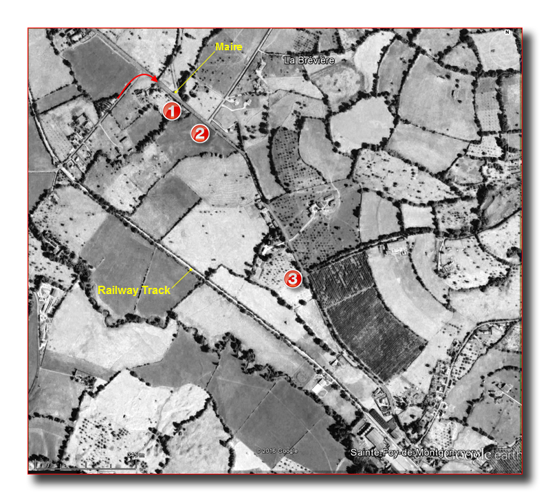

    NCAP_ACIU_4_0439_4132 is the only cover in the NCAP archive for the bridge/gate lodge area which was flown on the 17th July. As far as I can recall, the only other cover they hold is from a sortie flown much later in July. I'll embed the search result pdf here tonight so you can all see the other frames, though of course they will be low resolution.
    Here is the NCAP search results which we had done back in 2013:
    <iframe seamless="seamless" src="https://docs.google.com/viewer?embedded=true&url=http://www.normandy.whitebeamimages.ie/ncap/search_results/34799_vimoutiers.pdf" width="100%" height="600px"></iframe>
    Below is the location which I am wondering if it might better match the description in the report - its almost bang on 4 Kms from Vimoutiers; note the village of Sainte Foy de Montgommery at lower right:
    What if the car turned right at the red arrow onto the main Livarot/Vimoutiers road and came under attack somewhere between junction 1 and 3? The 'Maire' at junction 1 bears a remarkable resemblance to the gate lodge at the entrance to the Usine Laniel where Hauptmann Lang focused the ATB article in 1970. Did he mix up the two locations?
    Now there is an obvious problem with my three junctions...
    ...all three are on the left side of the road as viewed from the car traveling south-eastwards towards Vimoutiers - but what if the report was composed while viewing a map on a desk? Then the three side roads would be on the right!
    Just some thoughts guys.

    Hi Pat
    Many thanks for the images.
    It is indeed a puzzle.
    You make a fair point about reading the map but personally I very much doubt that was the case. I think too many people would have had a hand in it one way or another, including all the surviving occupants of the car. Obviously its a possibility but I think a very unlikely one although it would make the re-evaluation much simpler.

    Hi Ian,
    You may be right; its just a thought that occurred to me, but its good to think outside the box on these quests ;)
