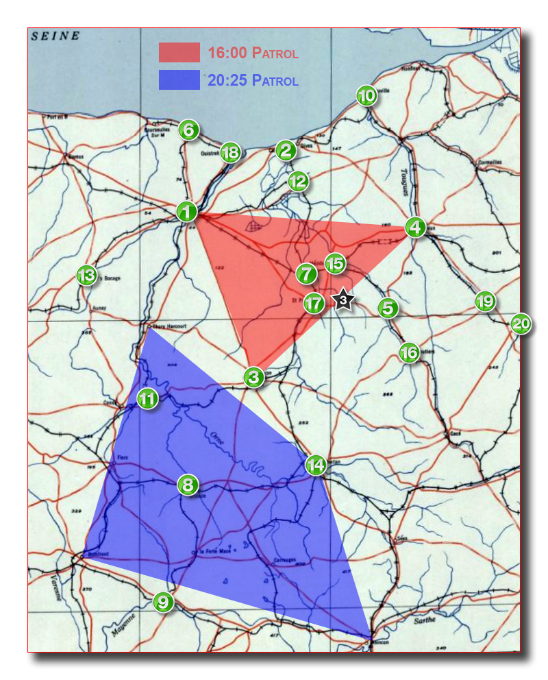

    After a week long trawl of 1947 IGN cover I have so far failed to find our railway embankment having checked over a hundred frames from the archive.
    Where are you hiding?...:dodgy:
    In order to get some structure on the hunt, I used stations and junctions as waypoints as set out in the map below. The area shaded red is the assigned area for the 16:00 patrol (Caen / Falaise / Lisieux) and the blue is the later patrol at 20:25 (Thury Harcourt / Domfront / Alencon / Argentan):
    The site of the 3rd attack at Boissey is shown with the black star and the table below gives the names of the stations and junctions corresponding to the green numbers on the map.

    You may wonder why I have gone so far outside the patrol areas and why I have included the narrow gauge lines running north from Caen to Ouistreham and Luc-sur-Mer for instance. Well, there is no good reason other than it can get a bit obsessive :D Its fascinating to trace the line on GE using one monitor while viewing the track on the 1947 cover on the other.
    The only line I have failed to find is the one leading south-westwards out of Alencon (14). I can see hints of it on the 1947 frames but am beginning to wonder if it was already closed by 1944.
    All of the track in the 16:00 patrol area is now checked but some remains in the later patrol's blue area, so more to do. I have the hundred odd frames saved in sub folders for re-checking later if anyone wants the job :D

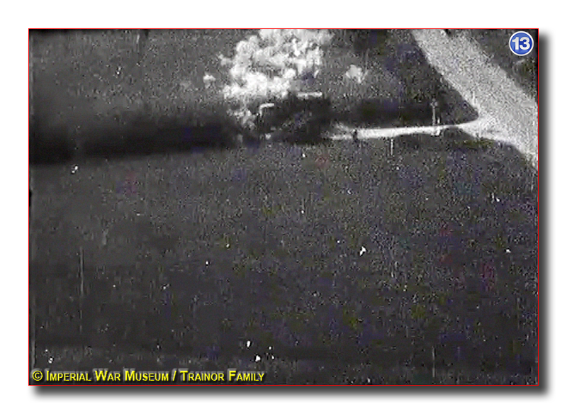

    I don't have much help to offer, Pat. My kingdom for a telephone pole (to cast a crisp shadow). At different sittings, I have been able to convince myself I see shadows from almost every point on the compass. For your own interpetation, here's what the calculator says the sun was doing:
    A) 1400 GMT - Altitude: 54 deg; AZ: 229 deg
    B) 1825 GMT - Altitude: 13 deg; AZ: 288 deg
    If forced to take a stand, I suppose I would guess the sun is to the right of the image. If those dark spots to the left are low bushes, it's hard to see how it could be the later time. The later time would make the sun at 13 deg. tan 13 is about .23. This means the shadow on the ground would be over four times as long as the vertical dimension of whatever object cast the shadow.
    From 1400 to 1500 GMT, the sun loses 8 deg of altitude and advances 17 deg in AZ. From 1825 GMT to 1925 GMT, it's 9 deg and 11 deg, respectively, for Alt and AZ.
    tan 54 is about 1.4. This means that the height of the object casting the shadow is about 1.4 times as tall as the shadow's length on the ground.
    So, pick a sun location and see if any of your suspects look more guilty.

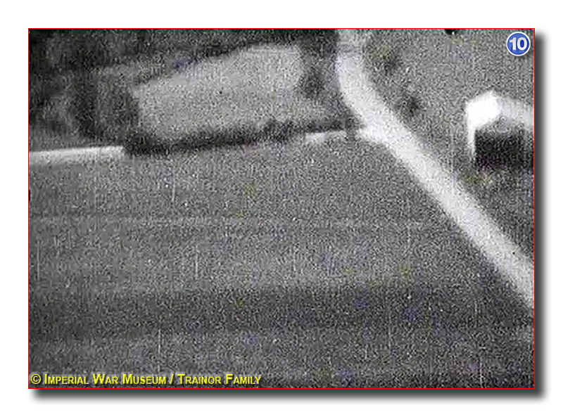

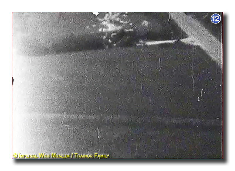

    OK, here are some of the best stills I could muster from the 2nd attack footage. Still No. 10 shows the scene just before Charlie Trainor opens fire:
    Here is what I see:
    • 'T' junction on a two lane main road
    • Open ended shed - note light visible on far side in open gable
    • Triangular field on the far side of the lane
    • Patch of scrub on inside of of hedge in same field (overgrown water course?)
    At first I wondered if we had another railway track but a 'T' junction would not make sense if such was the case. The shed or barn is at an angle to the road (not parallel). Most interesting is what at first glance looks like a tall sign post at the end of the lane. It took me a few stills to figure it out (at least in my mind)...

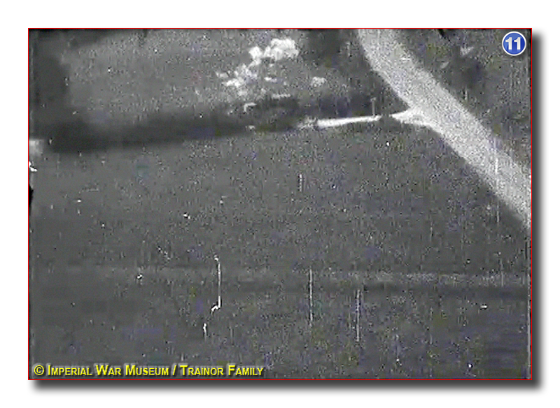

    Still No. 11 below shows the burst of fire hitting the field on the far side of the lane. This makes me wonder what exactly is the target? There appears to be a truck parked in the lane but the fire seems to me to be hitting over the truck. Is this simply a miss or is the fire directed at more than just the truck?

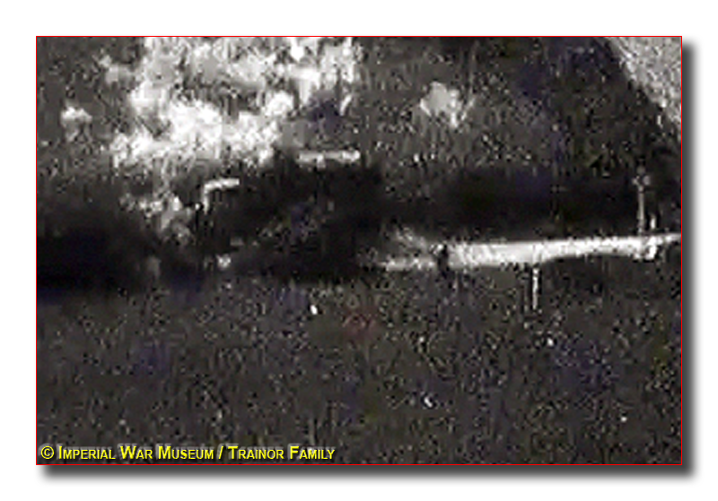

    Still No. 13 is probably the sharpest of the lot and reveals something interesting to me regarding the 'road sign'. I don't think its a road sign at all - it appears unnecessarily high. Looking at the object in still No. 13, I think this is a tall calvary crucifix with a short cross member. I wondered at the design if such is the case as it seemed out of proportion until I went hunting for old French postcards for locations in Normandy using the search term 'calvaire' on the ever fruitful delcampe.fr site. The search result can be seen here if the link stays alive. Note there are several examples of very tall stemmed crucifixes with short cross members.
    Another thing I have noticed is the puff of smoke to the right of the main impact area in the corner of the field - it never changes right through the full footage! Is this a weapon on the ground returning fire or it it just coincidence that the same spot is hit multiple times?
    Below is a zoomed extract from still No. 13:
    The truck (if that's what it is) seems to be parked with its rear toward the junction and the cab visible through a break in the near hedge. The cross at the calvary (if that's what that is) also seems to take on the expected appearance at the top.
    Are you guys seeing things the same?

  18. John Szweda
    Nice work with the still images!
    The only thing I am pretty sure about is that the truck looks alot like the American style 2 1/2 ton truck and there are a few simular German types like the Henschel 33 D1 or Krupp L3H. I checked on the dimensions of a 2 1/2 ton and it is 22 1/2 feet long, just under 7 1/2 feet wide and about 8 feet high. German versions are very close to these dimensions.
    Now what I am not sure of:
    The main road... or is it tracks? I look at the stills and I keep seeing some darker parallel lines that run along the road/tracks and I just can't decide either way. It could even be a double wide set of tracks.
    You make a great point on the T intersection road as far as why would it lead up to the track only.
    I don't know, maybe it just serves as a train stop or track service road?... if it is even tracks... see what this does to me. :/
    I also wonder why there seems to be no path out of the shed to the road/track.
    The Crucifix... or is it a crossing sign? I looks like to me to have the same symbol we saw on the "Halte" location before, but it also must be roughly 10 feet tall. Also there seems to be ground cleared and cut out at its base like we see with crucifix locations.
    It seems like Charlie Trainor is flying into the general direction of the sun based of the light reflecting off the upper truck surfaces, and the dark side of the truck to the camera. So if it is a crucifix we would be looking at the back and dark side of a crucifix. Or is it a X crossing sign facing down the road and we are getting some light reflecting off of it.
    I am puzzled, I have looked at it all so many times and I can't figure it out.
  19. Sean
    To echo John, nice work Pat.
    Looks like a calvary to me.
    John, I think it's a road. The Y-shaped tracks where it meets the wider road imply traffic from one to the other, I reckon.
  20. John Szweda
    You may be right and I lean the same direction you and Pat do, but I'm just not completely sure.
