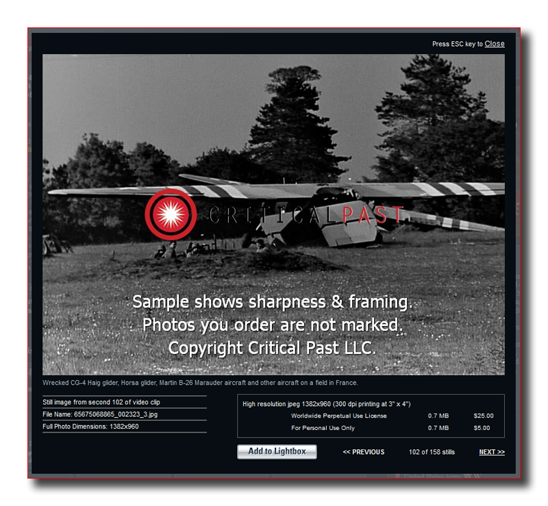

    Any chance of matching the Horsa wreck seen at time mark 01:36 in this Critical Past footage to the one which Charles referenced in his post here on the 'Hoatson Horsa Wreck' thread?
    Don't have access to my own PC just now.

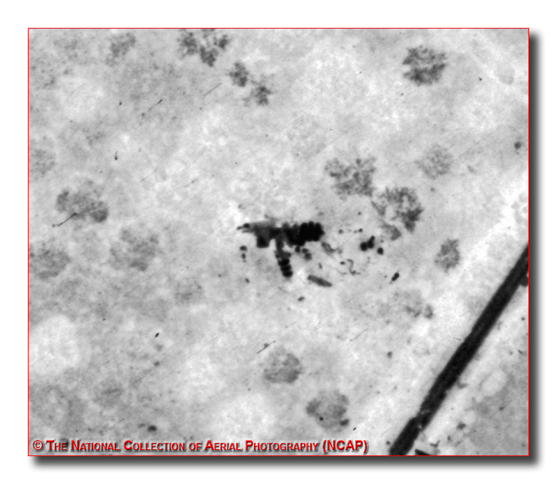

    Not the same certainty as John's Hoatson Horsa location, but I think we may have the ground footage of the wreck in the orchard located too. The AoI is indicated by the red rectangle on NCAP_ACIU_US30_4108_1002 below:
    ...and zoomed to here with an inverted version also to help matters along:

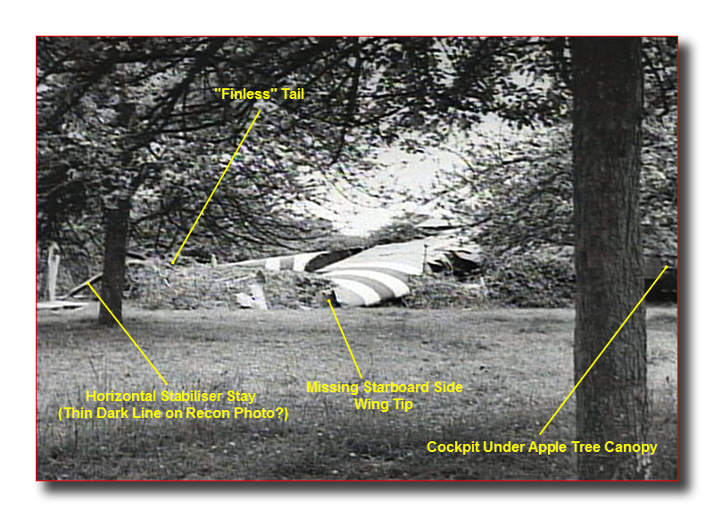

    I found a better version of the Critical Past ground footage and produced two good stills which hopefully tie in with the reconnaissance cover:
    Those of you who have the high resolution copy of NCAP_ACIU_US30_4108_1002 will hopefully see what I take to be one of the horizontal stabiliser stays as a thin dark line on the upturned piece of detached tail section...or am I seeing what I want to see? :s

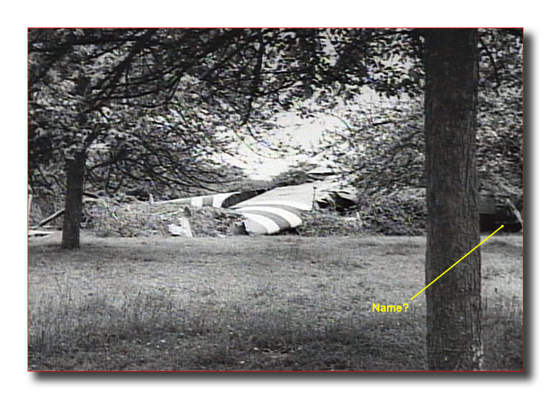

    In any event, please let me have your take on this possible match between ground and air. Do we also have a possible candidate for the Charles C. Bass, Jr. Horsa?
    I wonder what that name reads? :D
    I think you have a good possibility for a match.
    One thing I think you may have wrong is your camera angle . I think the camera angle is more likely from between the two lighter colored trees in the orchard to the east.
    Could be the angle is off a bit alright now that I look at it again.
    You can just imagine the camera guy shooting the Hoatson glider on the road and then wandering into the orchard and shooting this wreck - like we saw down south at the 'Edna' site in the Pond Field. Strange to think we are coming up on seventy years of a time lapse. I often wonder if, perhaps not these highly populated frames, but some of the other obscure reconnaissance cover we have looked at; are we the only people to have looked at these frames since they were initially assessed by the PIs?
  5. kgm
    I think there are several other possible “match” points. Look at the port flap area, the “debris” on the aft portion of the starboard wingtip and the shadows at the starboard wing root. I’ll send a comparison shot to you off-Forum.
    Once again, great job.

    Another impressive analysis! It does look like a very possible match of the aerial shot and ground shot of the Horsa glider across the road from Hoatson.
    I would, however, offer a different explanation regarding the possible horizontal stabilizer stay (which I don't think diminishes the likelihood of the suggested match). In the first of the still shots, if you follow the suggested stabilizer stay from the ground upward, it looks like it continues behind and beyond the dark tree, second from the left in the frame, making it look more like a tree branch, or a separate small tree. It appears to have small branches of its own which may be laying, in part, at the end of what remains of the starboard wing. It may not be a separate tree, however. Turning again to the very left of the frame, it looks like the glider may have caught a "branch" of the far left tree on the way down, tearing it off, and leaving what appears to be a light colored gaping wound on the trunk of that tree. Although we are able to see this tree in the aerial shot, we can't see the wound, simply because of the angle from which the aerial picture was taken.
    A question: In both of the Critical Past stills, we see sort of an elliptical shaped dark area above the starboard wing, near the very center of the picture. Are we looking into the separated rear section of the glider? Just trying to get oriented.
  7. John Szweda
    I see what you mean by the marked stabilizer stay being a bent over tree trunk and after thinking about it, I agree with you. It seems to be too long to be a stabilizer stay. The dark area above the center does look to be damage to the glider, but I dont think it was intended to get a jeep or 1/4 ton truck and trailer out. I think the seperation was a result of the crash. If they made the effort to break away the tail to get the jeep or truck out, they would have left the tail further away from the rest of the horsa. Maybe one possibility was that they cut away the forward section and removed it out the front under the tree. Until we look into the other Horsa wrecks, I have a little bit of doubt that this may be your father's Horsa.

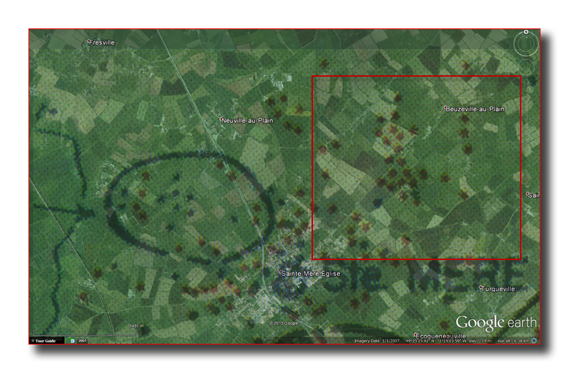

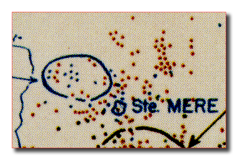

    I re-scanned the 82nd glider location map at 1200dpi to get a good quality zoom of the 'rust' (red & brown) markers showing the 32 - 34 serial locations NE of Sainte Mere Eglise...
    ...then overlaid it on a GE screenshot, using the western bend of the Merderet River and Sainte Mere Eglise as ties to geo-position:
    The red rectangle above is zoomed to below:
    It's a very rough representation of the locations for these four serials and I have no idea which is red and which is brown. I do note however the heavy concentration astride the D17 road NE of Sainte Mere Eglise which is our current AoI. Frame 1001 of Sortie 4108 should show more of the southern part of this cluster. A high resolution copy at 1600dpi is currently on order from NCAP and should be with us by the end of next week. A low resolution proof is shown below:
    Note construction of the La Londe A6 ALG underway at lower centre left which of course would have necessitated moving many of the gliders in that part of the cluster south of the D17.

    A little late in the discussion, but comparing the NCAP aerial of the orchard and the Critical Past ground shot, I found several other similar points that also support the case that this is a match.
    In the slide below, from the left to right:
    - In the NCAP photo, on the aft portion of the starboard wing tip, there appears to be a shadow or dark area. In the ground photo, there appears to be some sort of “debris”, possibly disturbed soil, foliage or tree material.
    - In both photos, in the vicinity of the starboard wing root, there appears to be a dark area, possibly a tear in the glider’s fuselage.
    - In both photos, on the port wing, there appears to be another tear, possibly related to the wing flap structure.

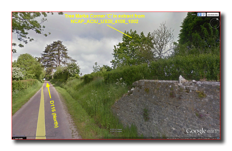

    As to Don's numbers, I was intrigued by the field corner at No.s 24-26 inclusive:
    This corner seems to be some sort of fortified position with perhaps a searchlight or AA pit at No. 25. What I take to be a barrack hut marked 'A' could be accommodation for flak troops manning a larger battery area out of shot to the east.
    No.s 24 and 26 seem to be slit trenches defending the weapons pit. I take the light toned rectangle at No. 24 to be cut vegetation to provide a field-of-fire northwards.
    I wonder what the L shaped 'B' object is attached to the eastern gable of the barracks? Perhaps a covered air raid shelter?
    The wall seen extending past field corner 'C' on the D115 appears to be now partly demolished as per the GE 'street view' below:

    I am pretty certain with the number of ties between the ground video and aerial photo, that we had found a match with the orchard wreck. As random as a glider wreck would be, too much seems to match in my opinion. Then with the front of the horsa likely cut away, it does make for a good match for what we would be looking for in the Charles Bass Horsa wreck. a combination of a wreck into a tree, and a 3 hour job to remove a jeep and trailer.
    Regarding # 23, I think it may be a complete wreckage with a wing laying over the top of it. It just seems like too much for just a wing. Initially I thought it was the wreckage seen in the critical past footage with the GI looking into it with his hands behind his back. It would need more studying, but i'm not sure.
    Also about points # 24 and #26, they are almost completely connected by a finer zig zag trench line. Also in my opinion, I think "A" is a cattle barn used as a barracks, and the L shaped "B" location actually protects some type of (farm or military) vehicle.
  18. firstflabn
    The orchard Horsa is interesting. Zooming the best ground level shot appears to show rough edges near the middle fuselage invasion stripe - consistent with using an axe. That access could equally be to rescue injured passengers or equipment (including handcarts).
    The damage forward of the leading edge of the wing likely is more than crash damage. To me the forward fuselage section appears to be detached - and rotated a bit counterclockwise (looking forward in plan view). For a dimensional reference point - the distance from the front edge of the rear plane to the trailing edge of the flap is very nearly the same as the distance from the leading edge of the wing to the tip of the cabin, so length doesn't bother me that much considering our limited perspective.
    So, my guess is they first tried chopping around the rear door. When that didn't get them the access they needed, they chopped off the forward section just ahead of the wings, then pulled it slightly forward and rotated it counterclockwise. The hard part to chopping involves the metal rods called longerons that act like very long bolts to compress the several fuselage sections together. No dimensions on the drawings, but they look maybe an inch or more in diameter. Anybody think to bring along any white phosphorus grenades to melt them?
    That was only a partial solution. As I understand it, vehicles were backed in to allow quick unloading after landing (might also have been a matter of weight and balance - unloaded center of gravity was just ahead of trailing edge of wing). Backing out a jeep/trailer or jeep/gun from a badly damaged glider would have had to be a last resort. Loaded trailers on Keokuk Chalk #13 weighed in at over 1800 lbs. each. But, according to LTC Bertsch, there were around 200 men in the area - so muscle power and desperate need could have wrestled a trailer or gun out the front. A jeep, of course, was powered and steerable, so just a matter of clearing a path.
    A final note: to me Pat's tail plane strut looks maybe more like an apple tree that got broken (but not severed) in two places - a foot or so above the ground and just below the canopy (the leafy kind). The strut is somewhere around 6-7' long; my 'young' apple tree looks longer than that. Here's a link to a pretty good look at the Horsa tail assembly (on the free part of fold3.com):

    In an effort to understand the parking of the gliders on the A6 ALG, I stitched together some stills from the Critical Past footage here. There are two separate panning sequences shown, the first one I have dubbed 'Spook' from the name on the nose of Horsa No. 14Dot. Here is a downsized version:
    The second panning sequence is shown below, dubbed 'Power Pole':
    The full size TIF files are uploaded onto my ADrive cloud if anyone wants them for a detailed examination:
    I am trying to place these two sequences in a 'bone yard' to the immediate east of the La Londe Farm Avenue. Not sure I have the correct location and sortie 4108 has no good cover of this field. There is shot of the left most Horsa wreck in the 'Power Pole' sequence on a different piece of footage which showed it as having another 'dot' number. IIRC, that footage showed trees being blown down with explosives, probably to expand the outer area of the ALG. Anyone know where this footage is located?
    I also wondered if the single frame below was the scene behind the AA position in the 'Spook' sequence but I don't think it is:
