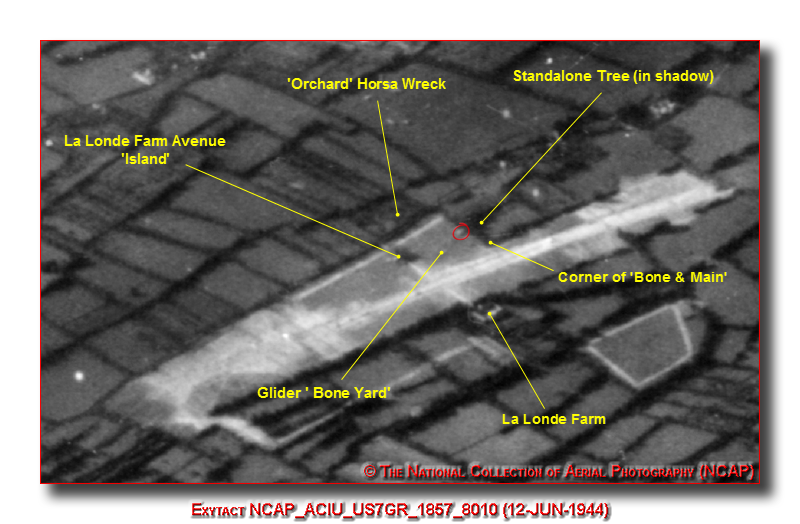

    In a further attempt to tie down post landing movement of Horsa gliders on the La Londe A6 ALG, I have extracted a view of the strip from the ever fruitful NCAP_ACIU_US7GR_1857_8010 flown on the 12th June:
    My suspect 'Bone Yard' for swept up gliders is the square area between the La Londe Farm Avenue and the intact hedgerow with the single Horsa circled red thereon. In an never ending effort to come up with place names for Don's amusement, I have dubbed the south east corner of this square 'Bone & Main' :D

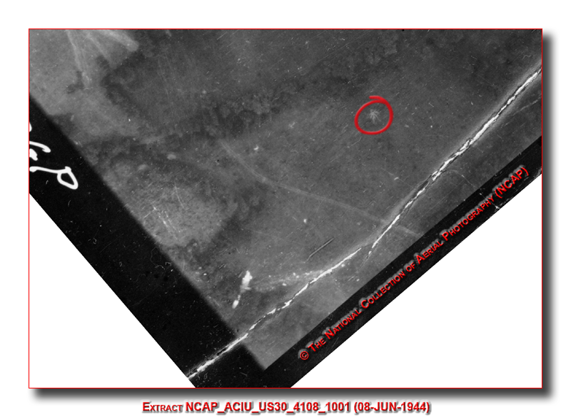

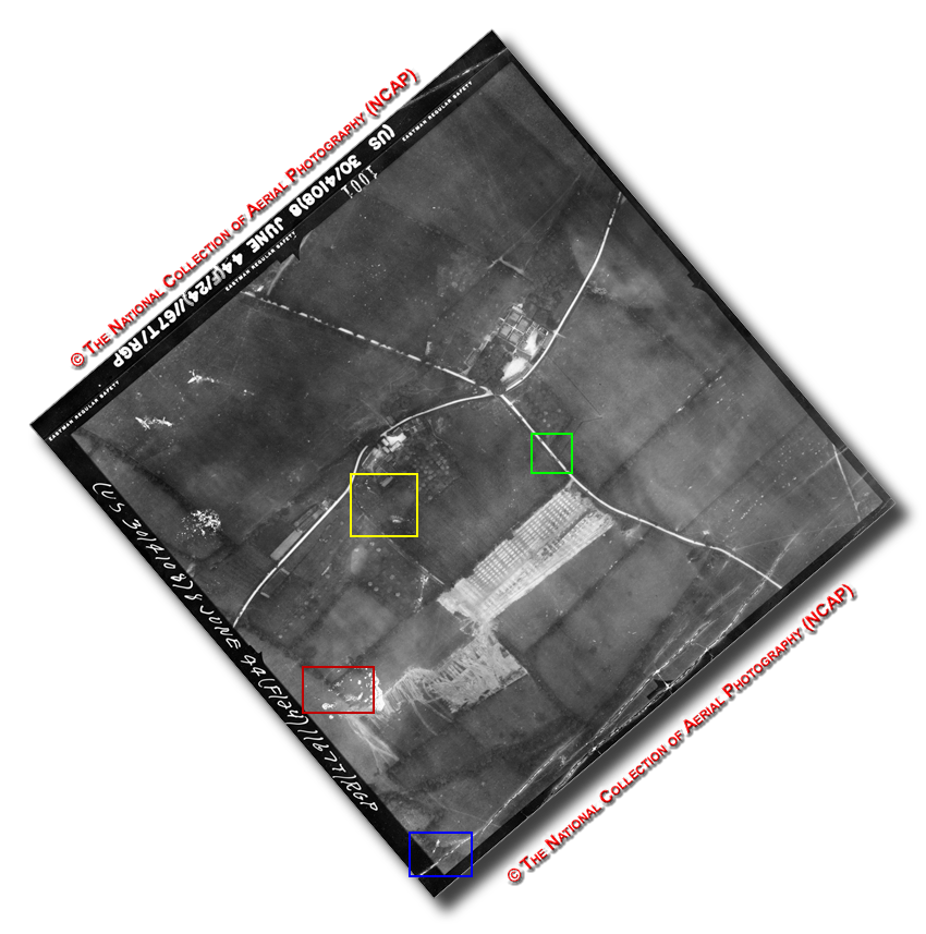

    We finally have the high resolution copy of NCAP_ACIU_US30_4108_1001 flown on the 8th June. My thanks to John for sponsoring this frame which is now available for viewing via the 'Green Room' library.

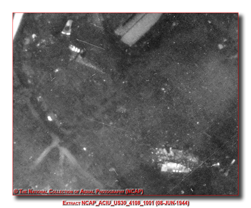

    Below is a down sized version with the first four areas of interest which caught my eye marked by the blue, red, yellow and green rectangles:
    The blue rectangle is zoomed to below and shows what I take to be a Horsa crash site with a run in mark from the east:
    The cockpit is at the 10 o'clock position under the tree canopy if I am reading the scene correctly.

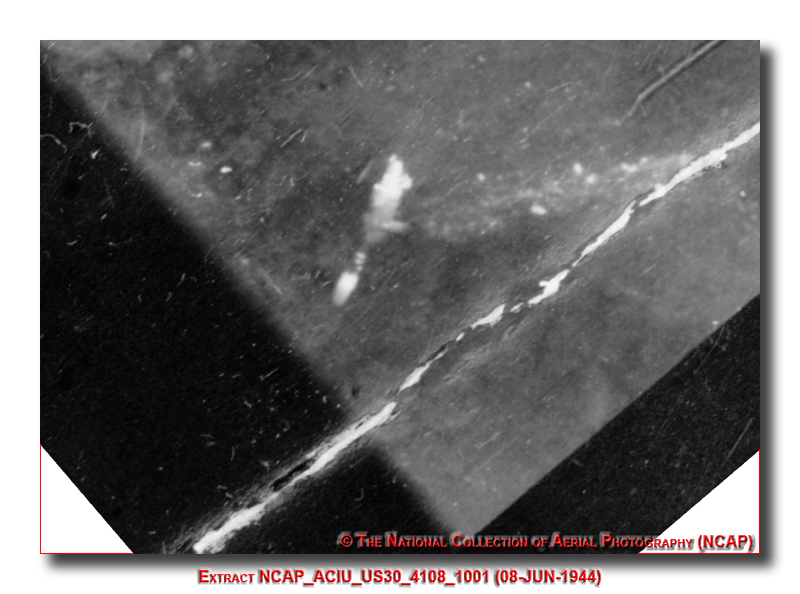

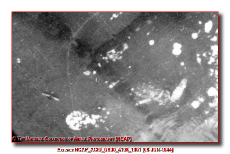

    The red rectangle shows another Horsa crash site just a few yards SE of 'Bone & Main' corner and appears to be the tidied up wreck we saw in the 'Eisenhower' image above:
    The small 'aircraft' like object at centre left appears to be a single seat fighter (a Spitfire?) ... or is it just a Horsa tail?
    I take the two areas of wreckage in the yellow rectangle to be from the same Horsa glider but again this may not be correct:
    Anyone make out this scene in the yellow rectangle differently?

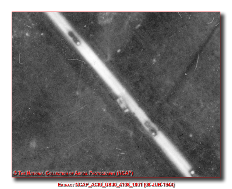

    The green rectangle is not directly related to the subject of this thread but it has caught my eye. Can anyone make out the light toned vehicle parked on the grass margin?:
    Comments and corrections are, as always, welcomed and appreciated.

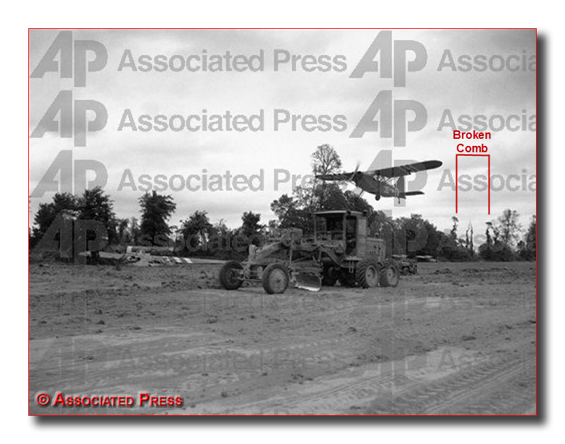

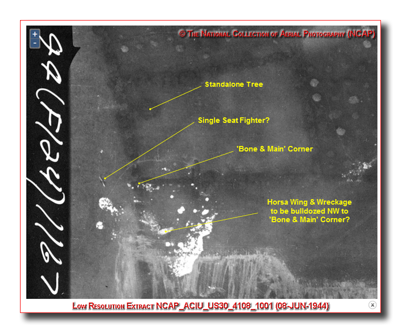

    Just another observation;
    I would wonder if the scene below shows the corner of 'Bone & Main' behind the cab of the scraper?
    It's definitively shot at La Londe A6 as can be seen by the 'Broken Comb' tree cluster down the hedge aways. If it is this corner, is the wing on the ground the same Horsa wing we see in the red extract from frame 1001 above?

    The blue rectangle has the Horsa coming in from the east, but I think the port wing hit a tree or hedgerow and spun the horsa about 170 degrees to the left so that the cockpit is actually at the 4 o'clock position. I base this on the general sloping back of the leading edge that is part of the wing design on the wing that points to 1 o'clock, and what looks like an insignia on the port wing. There seems to be an area of this wing that points to 1 o'clock that also has a missing aileron on the western side of this wing. Also the wings curves into the body of the horsa on the eastern side more like it is the leading edge of the wing. This horsa may have hit this hedgerow while it was spinning to the left, with the right (starboard) wing first sliding between trees.
    Just my opinion.
    The red rectangle is see a starboard wing as the biggest piece of the wreck, and what I believe is a horsa tail in the field. In my opinion I don't see enough for there to be two wrecks in this area. I do see a number of parachutes at the Bone and main corner.
    I agree with you on the yellow rectangle that the wing is from the horsa under the tree. American insignia's were placed on top of the port wing and on the bottom of the starboard wing. I can see no insignia on this wing so I think the separated port wing lays upside down with its internal wing storage compartments open and empty. Notice how the wing stripes cannot be seen mid port wing.
    The green rectangle is interesting and I think it may be a german vehicle by the lighter tone of possibly a tan vehicle. To me it looks like it could be a Stug III or even a slighter possibility of a Marder. The smaller tan box behind or on top it throws me off and gives me some doubts though.
    Again these are just my opinions, so please feel free to agree or disagree. I like to view these images from different orientations without thinking north/south. As we did before with image 1002, I often look at frame 1001 rotated 180 degrees. Rotating the photo seems to help me when analyzing the aerials.

    The vehicle parked up in the yellow rectangle seems too narrow to a German SPG but Niels or Sean might be able to throw more light on it. There is a good possibility that it could be related to the construction of the ALG and so be American.

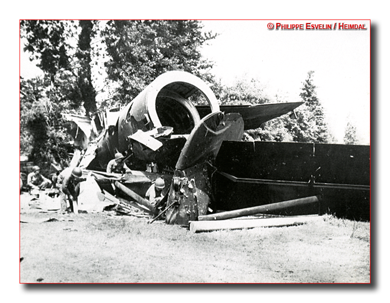

    While looking through Philippe Esvelin's books for Dale last night, I found a ground photograph which might match the tidied up Horsa wreckage at the corner of Bone & Main. Will post it tonight.
  16. marketc47
    I agree with Pat for use of only Waco gliders on resupply.
    This is the photo I am wondering about:
    It is taken from page 70 of 'Forgotten Wings' by Philippe Esvelin. If you look over the head of the GI down on his haunches at extreme left, the hedgerow seems to be running in a receding line behind him and the trees on the extreme right seem to be heading off at a right angle to the left hand hedgerow. Have we a corner behind the fuselage part of the wreckage? If so, is it Bone & Main?
    The whole setup gives me the impression that the wreckage has been bulldozed into a pile.
    Weak, but possible.
