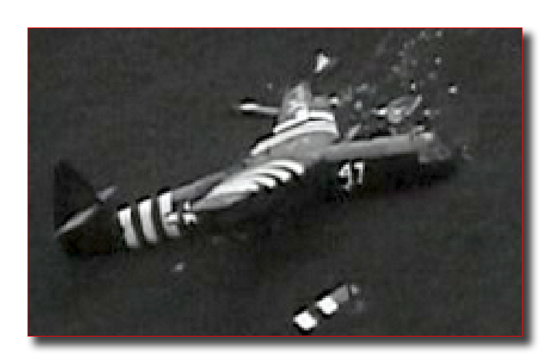

    Do you recall the Horsa caught by the BP Film 1981.12 footage shot from the spotter plane orbiting the A-6 strip which I referred to in post #119, page 12 of this thread? Below is still #197 showing this Horsa, possibly marked '47' in Elmira style script:

    What do you make of the number?
    '47' with no underscore tick mark is my best guess. The 'tail' at the bottom left of numeral 4 might be a crack in the fuselage - very like the '18' in your 'Jerry Can' wreck.

    I think this extract from still #198 might be the sharpest of all:
    Can't be sure of the '4', but the second digit is now a much better '7'.
  5. John Szweda
    That is a little bit more convincing :)
    I'll go with 47.
    Can we safely say there is no underscore tick mark?
  7. John Szweda
    I would also agree that there is no underscore mark.
  8. Jonesy
    No under or over score which means it is not a 435th or 438th TCG Horsa.
    This could be a 436th TCG Horsa who had the chalk numbers around there and very boldy painted. See the Hoatson Horsa and one other Horsa at la Londe to see what I mean.

    That is really excellent work on the Horsa that may very well be chalk #47. Now we have an image of that glider that is far superior to the NCAP one which doesn't give a lot of detail.

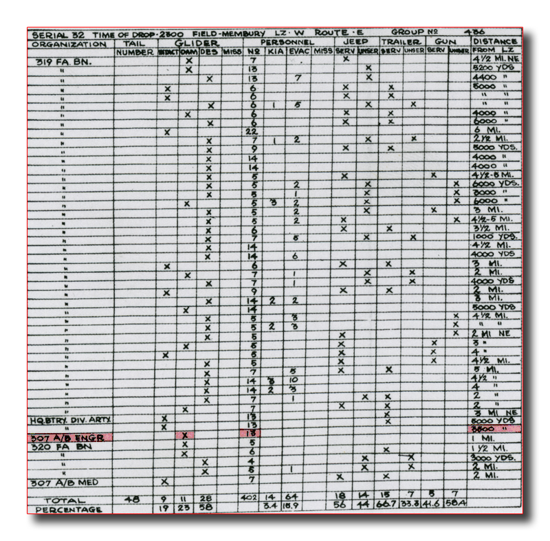

    I see from the Horsa Serial 32 table below that although the original British serial numbers are missing from the listing, only one carried members of the 307th Airborne Engineer Battalion, so 'DP 379' must be the glider shaded red:

    For my education, can someone clarify two things:
    The glider number is shown to be DP 379. I am not familiar with this type of number. Were they actually applied to the Horsa gliders? If so, where on the glider were they applied and are they visible?
    Also, looking at the flight chart, I had expected to see the subject glider in 47th place on the list. What I find is that it is in 45th place, counting the two CG4As in Serial 32 as numbers 1 and 2, and then continuing the count down to the 307 A/B ENGR Horsa, (basically considering the first Horsa to be number 3). Could a couple of gliders happen to have been out of place on the take-off?
  15. John Szweda
    If you are looking at the chart for Serial 32, look on that same chart at serial 31.

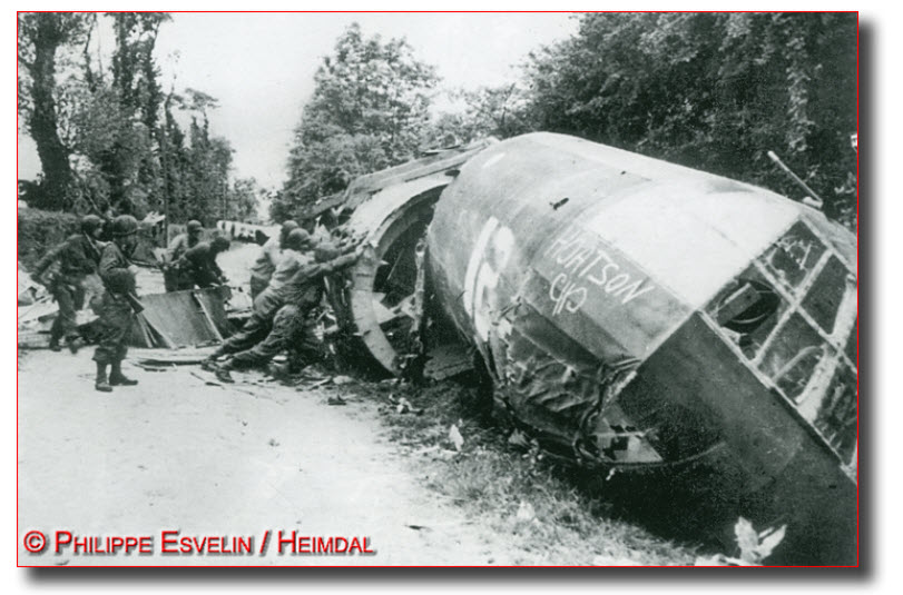

    I was looking through the Hoatson Horsa Wreck thread, specifically at the very first post on that site by Pat, in which an image of the Hoatson glider, as presented on pg. 119 of Philippe Esvelin's D-Day Gliders, is shown. It looked to me like there may be a marking of some sort below the number 12. Following is that image:
    Hoatson Glider.jpg ​
    While the marking is not particularly clear, or perhaps not showing fully, something is there.

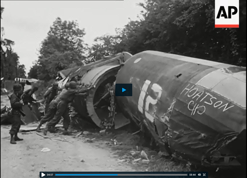

    In post #34 of the final page of the Hoatson Horsa thread, Pat addressed the value of looking at the British Movietone footage version held by AP, of very similar footage held by British Pathe. As noted, sometimes there may be found additional footage that could be useful. The footage noted in that posting was identified as 'Consolidating in Normandy - NO SOUND". In reviewing that footage, particularly the part which shows the Hoatson glider rolled towards its port side, with the chalk #12 clearly shown, we get a considerably better view of the spot under the chalk number. Below is a screenshot of a part of that footage:
    Hoatson Glider from AP footage.jpg ​
    The timeframe on the footage that shows this view runs from 4:06 to about 4:10, and is pretty consistent throughout that segment. I don't know if this marking is a "dot" as has been identified on several other gliders, but it might well be. If so, it could tie into the 436th TCG, and since Hoatson was with the 82nd TCS, that squadron as well. The footage can be accessed here:
    All thoughts on this will be appreciated.
