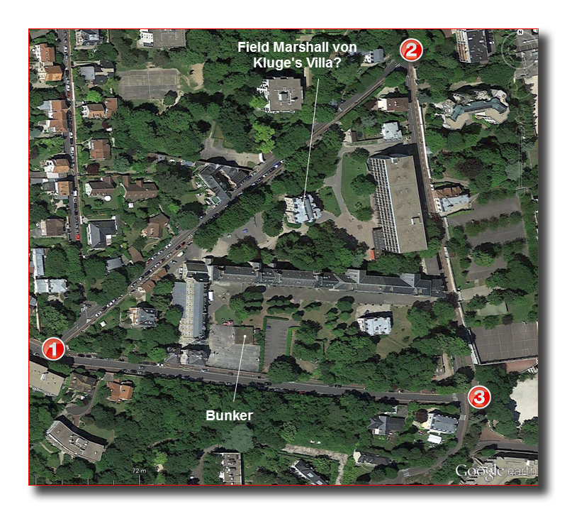

    I've been digging to see if the location of Field Marshall von Kluge's HQ at Saint Germain en Laye is known and not for the first time I have found that the answer appears in Jean Paul Pallud's excellent book 'Ruckmarsch!' (p.47). The author tracked down several ground photos to what is now known as College Marcel Roby at 31, Rue Alexandre-Dumas. The school is named after a mathematics teacher from the school who was a Resistance fighter arrested by the Germans in 1942 (some sources say 1943) and died in Buchenwaild in March 1944.
    Below is one of Jean Pauls finds from the German Bundesarchiv, showing von Kluge with his staff at his villa in the school grounds. The date is 11th August 1944 and it must be one of the last photos taken of the beleaguered Field Marshall before he committed suicide on the 19th August:
    I cannot be sure, but I think the villa marked below within the triangular school grounds (1-3) was the Field Marshall's HQ:
    Anyone able to confirm or correct?

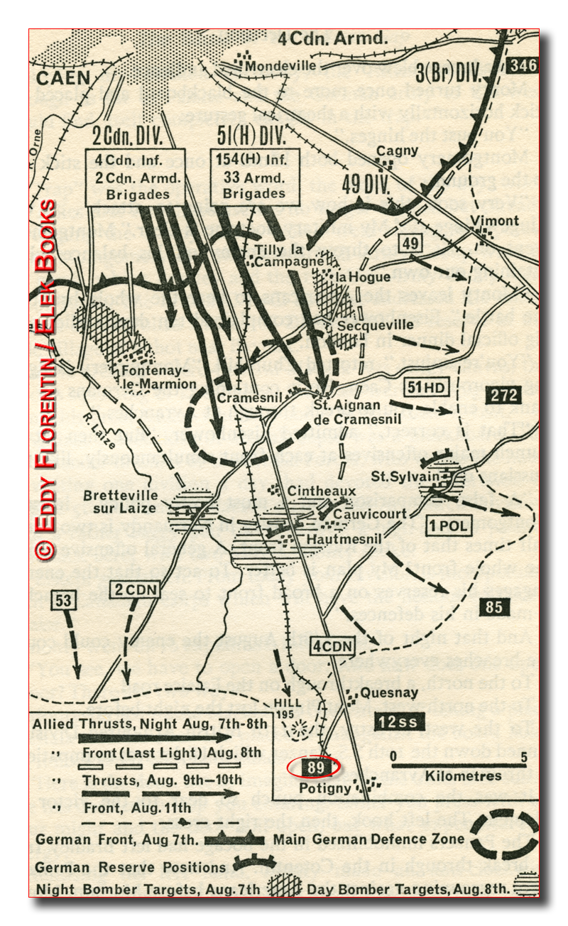

    Do you have anything on their short time in Normandy? I presume their arrival from Norway sometime during the first week of August was their first tour in that part of France?
    I note their location NW of Potigny on the 11th August on the map below from page 70 of the book:
    Any information from war diaries or other sources would be welcome.
