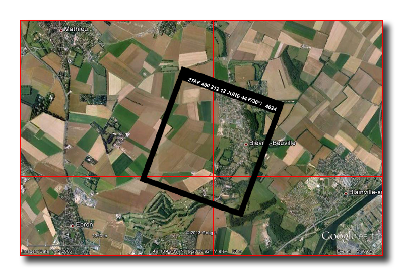

    The high resolution copy of NCAP_ACIU_2TAF_400_0212_4024 has come down from Edinburgh today. Below is a downsized version suitable for posting here on the Forum:
    ...and below the GE finder chart with the coordinates from T/Sgt Shimko's report marked thereon:

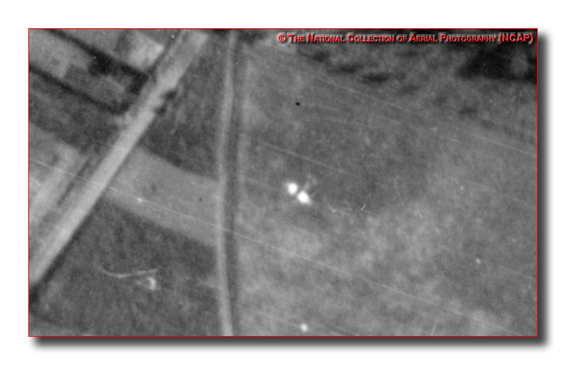

    The quality of the high resolution copy is not the best by any means and I can see no conclusive sign of the Waco which brought T/Sgt Shimko and his men to Normandy. The one possibility I have seen so far is not at my 80% certainty level, but members with 'Advanced Researcher' status can check the high resolution version to see if they can find any other candidates thereon. My 'possible' is located at the centre of the red rectangle at bottom right on the down sized version above and zoomed to below:
    ...and an inverted version:
    Image Credit: RCAHMS/
    www.aerial.rcahms.gov.uk
    If the object is the sought after Waco, the nose seems to be hidden by the crop growing in the field, though I cannot think of any such crop which might have reached this height in June :huh:
    I have seen the invasion stripes on glider wings 'flaring' like this into two single reflections before, especially where the quality of the master print is not great, as in this case. The tail fin at the 2 o'clock position seems to be casting a dark shadow in accordance with the direction of other shadows. The two horizontal stabilizers also seem to be showing as one would expect.
    ...not sure though :dodgy:
  19. John Szweda
    These are just my personal opinions, but just some of my own quick observations are that the scale of this object seems too small to be a glider when compared with trees, road widths, homes, etc. I just get the impression that a glider would be twice this objects size.
    Also the light reflection angle seems to be off. With the sun to the East (right) in this photo, most of the houses and farms above this object with a somewhat easterly facing roof seem to be reflecting lighter. It just doesnt seem to fit the manner in which this object lays on the ground with a nose buried down at 8 o'clock, and tail up at 2 o'clock. Also with the low sun, even smaller trees and objects are casting obvious lengthy shadows. With a tail up, I would think we would see more of a casted and obvious shadow.
    Just some of my observations.
    John Szweda
    Would it be crazy to think this could be a Spitfire if its a plane at all?
    Yes, it is a weak candidate.

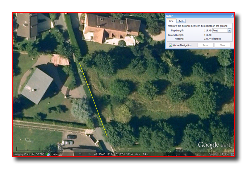

    My 'rough and ready' attempt below at scaling the object was hindered by the fact that the area is now built up hugely since 1944 but I did manage to find two hedges which are still present today. Depending on how much faith you put in Google Earth's measurement tool, I get about 120 ft between them along the laneway:
    The object seems to have a 'wingspan' of about ΒΌ this distance or about 30 feet. If my measurements are somewhat correct, this does indeed rule out the wingspan of a Waco at 83ft 8inches. A Spitfire, depending on the variant, had a wingspan of 36-40ft and hence would fit very well with your theory.
