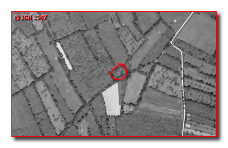

    ...its not beyond the bounds of possibility that the glider is showing on 1947 IGN cover :dodgy:
    There is certainly something there throwing back extra light :D

    I am assuming a Waco is what we need if I am reading this story correctly?
    In my opinion, I think we are looking for a Waco.
    The story reads that the glider had a bulldozer and one crewman.
    Given that some Waco gliders carried in the dozers, and that a Horsa would have the ability to carry a larger load (in either men or equipment) than just a dozer, I'd suggest it was a Waco.

    Yes, it looks like it John.
    Glyn, from your first post, can you confirm time and date at which the glider landed?
    Also, I am not sure if this is a candidate, but can anyone confirm the complete serial number here. I am getting 43-198_5_
    In a slightly better resolution photo I see it as 319885.
    Comparing it with other Waco glider serial number lengths, I don't think there is a digit after the 5.
