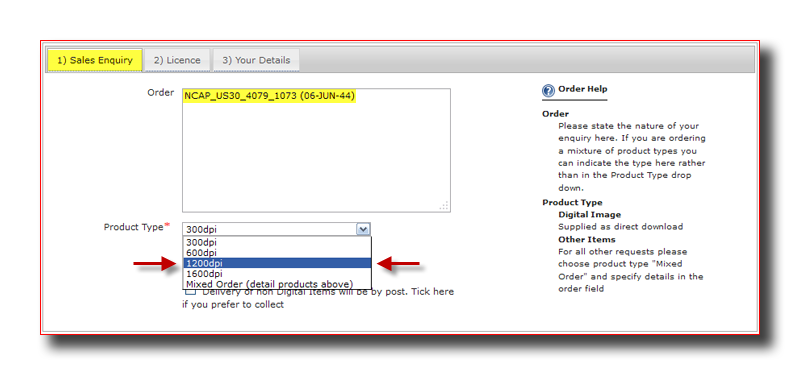

    The order form has three tabs and tab 1) Sales Enquiry is open by default. In the 'Order' field, enter the full name of the photograph you require, including underscores to avoid spaces as in the screenshot below:
    The ‘US30’ part of the file name seen in the Order field above here may not be part of your photograph title. In this case it refers to the USAAF 30th Photographic Reconnaissance Squadron, 67th Photo Reconnaissance Group.
    Next select dpi level from the drop down list in the ‘Product Type’ field. I normally select 1200dpi as I believe this is the resolution limit of the master prints from which the customer’s TIFF file is created. In my view choosing the more expensive 1600dpi setting will only produce larger versions of fuzzy detail not visible in 1200dpi files.

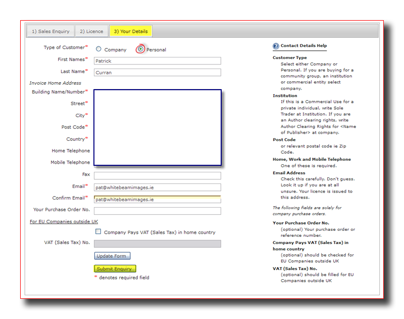

    Finally, in tab 3) Your Details, enter your contact details (phone numbers are required even though the fields are not marked as mandatory):
    Ensure your email address is valid as this is the normal mode of contact during the ordering process. When all fields are filled in here, go back and make sure you have entered the name of the file required correctly in tab 1. When everything is in order, click the ‘Submit Enquiry’ button at the bottom of tab 3.

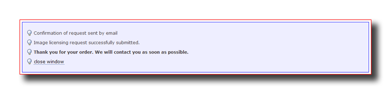

    If you have completed the three-part Order Form correctly, the following screen will appear:

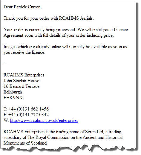

    A few minutes later, you should get an automated email from NCAP like the example below:

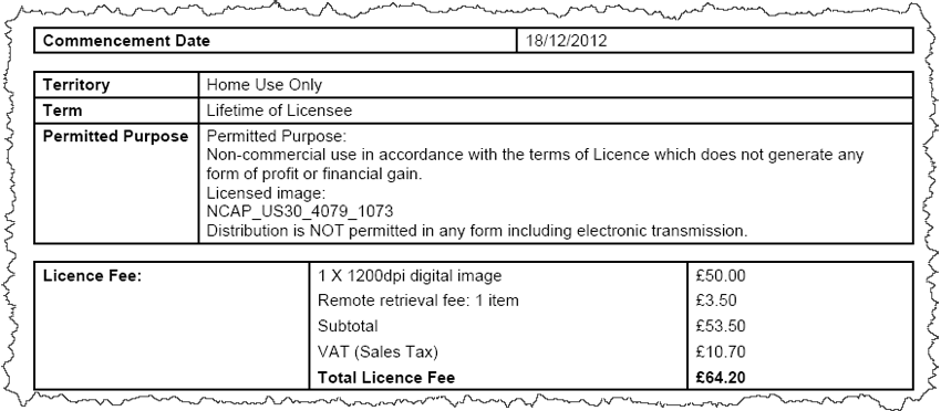

    Today I received the pdf licence to which the customer must accept the terms and conditions online. Below is an extract from the licence summary section:
    Note that there is a 'pull' fee of £3.50 which is a charge levied to cover the cost of physically retrieving the master print from the NCAP storage facility prior to scanning.
