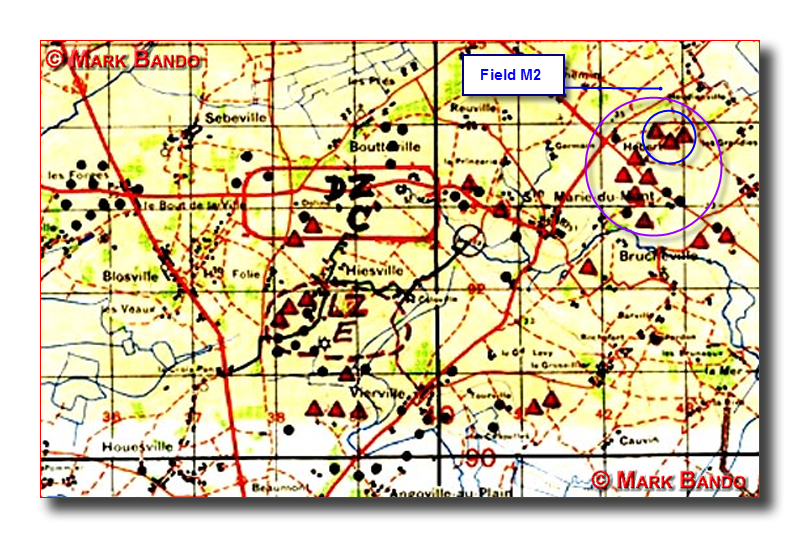

    Don,
    Is this the map you are looking for?
    The lone Waco beside the pond seems to be marked with the black dot...not sure how many Horsas each red triangle is meant to represent.

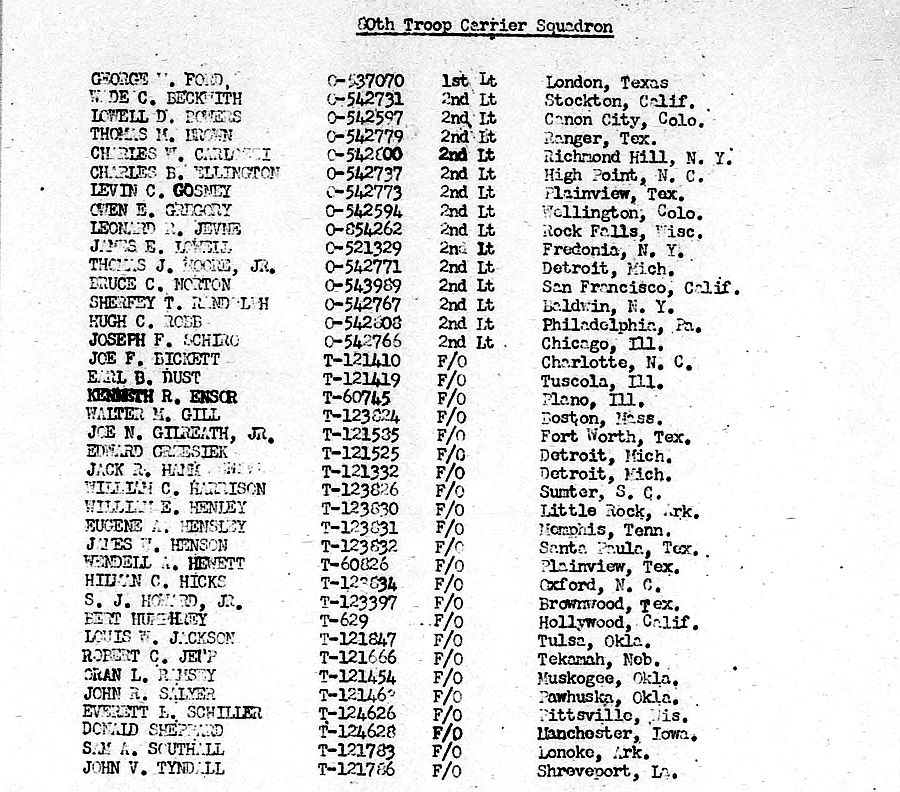

    I'm amazed at how much I forget. I found some more information that Mr. Randolph sent me on the 80sq. The following is a list of the glider pilots that flew into Normandy. I do not know if the list follows any order.
    436th TCG 80th Sq
    Glider pilots that flew into Normandy June 6th 1944
    George W. Ford – Thomas J. Moore Jr. “Irish”
    James E. Lowell – Edward Grzesiek
    Hugh Robb – Levin Gosney
    Charles B. Ellington “Smoky” – Joe Gilreath
    Lowell D. Bowers – Kenneth Ensor “Ray”
    Oran Ramsey – Sam Southall
    Wade Beckwith – S. J. Howard
    Leonard R Jevne – Own Gregory
    Joe Bickett – Sherfry Randolph “Tip”
    Charles Carlozzi – Earl Dust “Dusty”
    Robert Jeep – Jack Hamm
    Bruce Norton – John Tyndal
    John R. Sayler – Bert Humphey
    Tom Brown – William Henley
    I hope this will help with the research.
    Be Well
    Dave

  5. Jonesy
    Dave, General Order #33 lists all the Glider Pilots who flew in the D-Day missions. I'll post up the 80th TCS section when I get home from work. Patrick may beat me to it though.

  8. Jonesy
    Here is the list of all Glider Pilots from the 80th TCS who participated in the glider serials on D-Day and D+1. A few of them were on detached service to other Troop Carrier Groups.
    Lt's Brown & Schiro and Flight Officers Schiller, Sheppard, Henson, Henley, Hicks, Harrison, Gill, Jackson, Hensley & Hewtt were on DS to the 437th TCG.

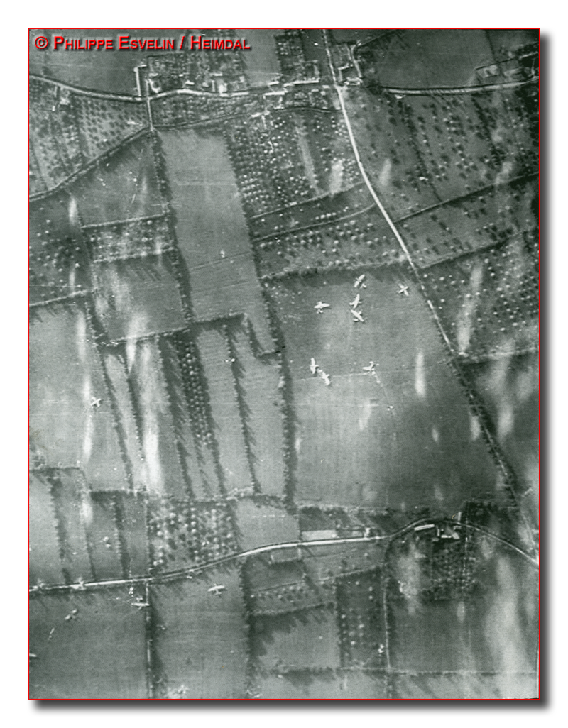

    Looking at the Sainte Mere Eglise area, I think it might be no harm to check the Horsa cluster in the large field across the D17 road from the A6 ALG at La Londe Farm.
    Below is an extract from aerial reconnaissance cover (sortie unknown) which is shown on page 60 of Philippe's book 'Forgotten Wings' and reproduced here with his permission:
    The large field at center right holds the Horsa cluster in question and the location of the extract is shown on the GE screenshot below:
    I cannot be certain, but the above extract is probably from sortie US30_ 4108 flown on the 8th June.
    Can anyone with a high resolution copy of NCAP_ACIU_US30_4108_1002 have a look please at this Horsa cluster and check to see if there is a glider in any of the four hedgerows of the field; also if any of the gliders is a Waco. Checked it just now myself, but I want to be sure...

  19. ddayHorsa
    Hi Pat, and all following this thread,
    Looking at the high res. version of us30_4108_1002, I can't really say that I see a glider hidden in the hedgerows of that image. The only thing that caught my eye is something in the top hedgerow, which with a significant zooming in, gives the impression of white striping. Whatever it is is located directly above the horsa glider that is pointing obliquely at the top hedgerow, the Horsa with its tail removed and facing backwards. Looks like it is in or under a tree. I would post a zoomed in copy of the image, but my Photobucket program has apparently decided that I cannot do so. I need to take care of that. Anyway, really zoom down and I think you will see what I am referring to. What bothers me a good bit is the small scale of the object.
