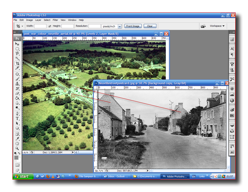

Hi all, Going back to the Turnbull action at Neuville, I am having a hard time trying to identify the position of where the 57 mm AT gun was. All reports say it was along the side of a house (I think east side of the house) and the sketches seem to be off in my opinion. I am currently looking at RCAHMS aerial photo of US30/4066 6 June frame 2101. The most forward object seems to be a long barn that is part of a complex perdendicular to the N 13. further back near an intersection seems to be the house that fits, but it seems too far back to communicate with the squad that was forward in known positions and any German armor would seem to approach very close to the squad (way too close for comfort). Also the barn would be an obvious barrier for communication with the squad and may even obstruct line of fire. Can someone help me out with this because the aerial seems to complicate the issue for me now. You may need to look at the aerial. Respectfully, John Szweda
Hi John, Where are you looking exactly? I'll zoom in when you point out the house you are looking at. Regards, Pat
Pat, I believe it is the one on the right in the black and white photo. It just seems to far back from Turnbulls squad for communication and defense of the squad that is more forward and unobserved beyond the long barn. I thought the AT gun was on the right side of that house. Doesn't the line of site for the AT gun seem obscurred by the long perpendicular barn as well? I guess if the gun was on the N 13 side it would make more sense, but that isnt the way it seems to be in the night drop sketch. John
John, it may be important to realise the maps in Night Drop are not 100% accurate. Do not trust them without checking! Veterans have expressed problems with Marshall's work at many points as well. The Neuville maps is one of the worst, that also has to do with its 'medieval' design: raised buildings, instead of looking straight down. Even if the gun was on the highway, it would be impossible to draw it there. Another problem: did the buildings at the tip of the arrow 'First German advance', ever exist? Can't find them anywhere.... The map in the combat interviews - which aren't perfect either, but do reflect the original interpretation of the events - does look down straight, and it puts the gun on the N13, basically on the level of the buildings on the left (west) side of the highway. Also don't forget it was Vandervoort who brought the two guns forward, he positioned the AT-guns, not Turnbull. Having the gun in the best possible position is more important than communication with the platoon: shoot if you see enemy vehicles. Also it seems Vandervoort talked to some troopers in the center of the village. Turnbull had reportedly sent two riflemen and a bazooka man back to the center of the village to stop any German armor that broke through the platoon's line. Maybe Vandervoort met with them? Speculation mode on: Assuming they planned on hiding the gun, it would make sense to hide the gun in the shadows and behind cover. Because of th LOS, I guess it was placed against the buildings, and possibly partially shielded by one of them. Placing it below the commerial sign on the left of the photo might well be the best position Neuville offers: possibly shade, and partially shielded by the building while still having a LOS to cover the entire highway. Placing the gun on the right side of the road, means there will never be any shade to hide it anyway. However, much may also depend on the timing. Was there enough time to properly place the gun, or did it have to into action before they could? Speculation mode off. Everything seems to agree Vandervoort left the AT-gun on the N13 at the center of Neuville. Makes sense any way I look at it. Only quesition is where exactly. Aerial photographs may answer that question, but usual accounts do not seem to have enough information. Or maybe Michel DeTrez book on Vandervoort...
Hi Niels, Thanks for your great answer. I guess I got lost in the squad defense and completely overlooked the gun arriving later as a separate defense with Vandervoort. I did read in "Four Stars of Valor" at the top of page 164, that "About noon I went north to Neuville-au-Plain in a jeep with a 57mm antitank gun and gun crew. I told our 57mm crew to go into position on the right of the road where a house offered some concealment..." I also got lost in the assumption that the gun was on the right side of the house on the right too. You are right about the buildings or barns forward on the left side. I dont see them in the aerial either and also wonder if the ever existed or were a bad representation of the farm complex and way too far forward. Respectfully, John Szweda
