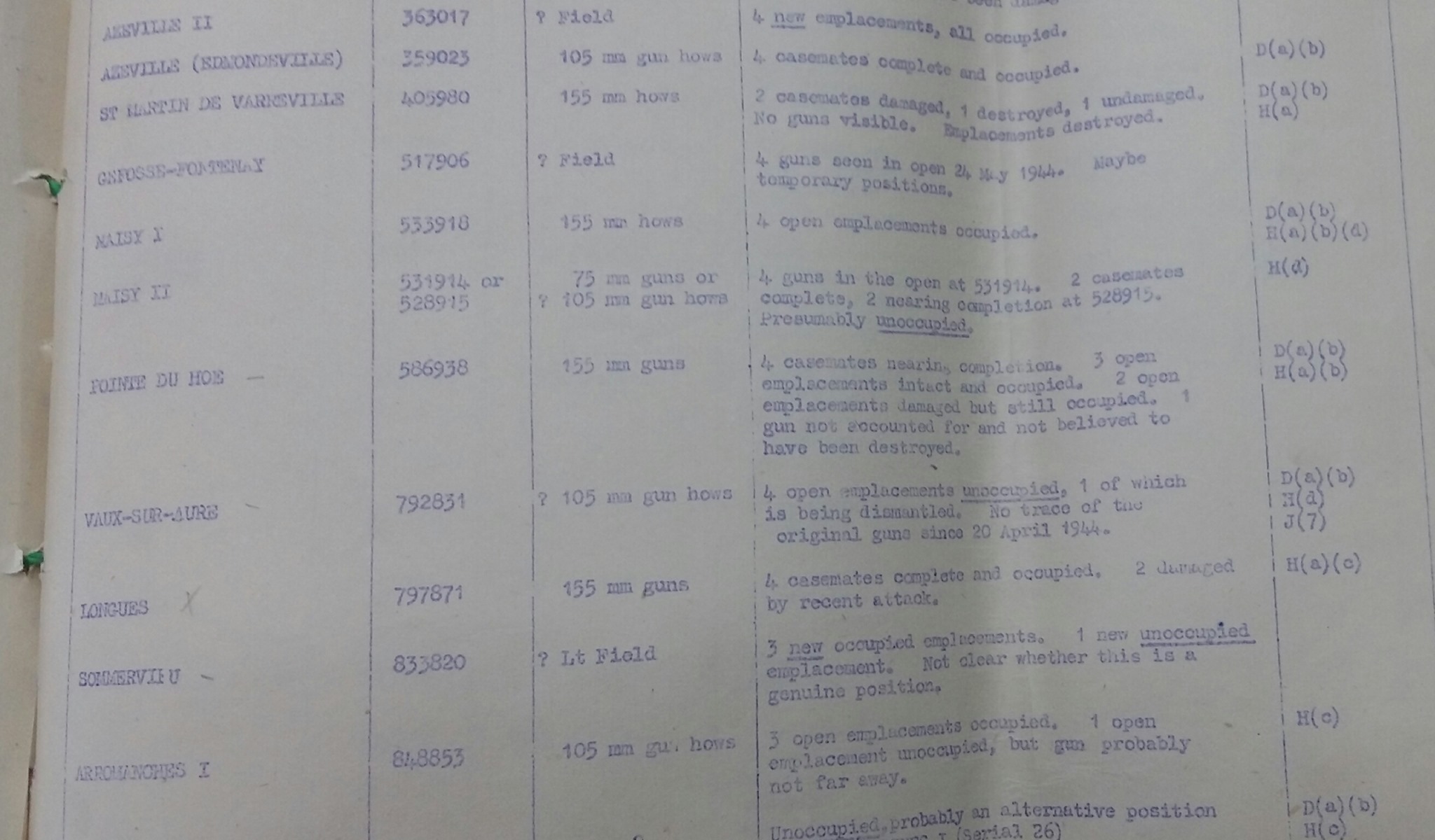

    I pulled this file from Kew today, as it covers two ongoing conversations, this one and another elswhere. In it is a descriptive list of coastal batteries including both Maisy sites. Date as you can see is 23rd May, 1944
    Note the calibre supposition for Maisy II. From the earlier guess at 77mm guns we're now at 75mm guns or 105mm howitzers. Given the fairly old-fashioned look of the 10cm Czech weapons and the uncertain nature of the intelligence assessments, I would suggest that this lends more credibility to the fact that the battery in the fields was in fact the four guns due for the casemates, and not another battery.
    Thank Sean,
    I tend to agree with your assessment.
    Does the term 'unoccupied' in that document indicate that a particular site is a dummy or is that its a viable site not yet complete?
  17. Jpz4
    Unoccupied seems to mean just that: no guns present. Why a position is unoccupied can have several reasons. Guns could have been removed or not yet installed. Going by this document is would appear that 'unoccupied' is only used for positions in a condition sufficient to house guns. Positions under construction don't fit that requirement.
